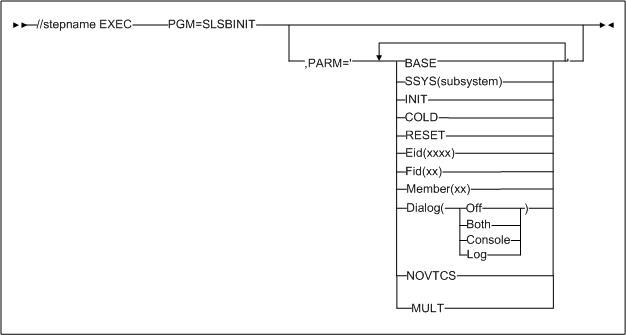

ELS now supports the ability to run multiple instances of HSC on the same LPAR. The following restrictions apply when HSC is started in MULT mode:
If any HSC on the LPAR specifies the MULT parameter, then all HSC subsystems on that LPAR must specify the MULT parameter.
Two HSC subsystems on the same LPAR must represent separate tapeplexes, that is, each HSC must point to a different set of CDSs.
ExPR started task is not supported on any LPAR where HSC is running in MULT mode.
A new parameter, SSYS, is required on any SLUADMIN step running on an LPAR where HSC is in MULT mode.
The SLIEXERS installation utility cannot be run on an LPAR where HSC is in MULT mode.
Any application using the HSC Significant Event Notification (SEN) facility on an LPAR where HSC is running in MULT mode must be modified to pass a subsystem name parameter. Refer to the ELS Programming Reference for more information about the SEN facility.

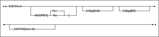

The following are recommendations for running multiple HSCs on one LPAR:
Each HSC subsystem should specify a unique command prefix.
Each HSC subsystem should specify MSGPRFX(YES) in its EXECPARM parameter. Using this parameter, along with a unique command prefix, identifies the HSC subsystem source for HSC console EXEC JCL parameters. Using this parameter, along with a unique command prefix, identifies the HSC subsystem source for HSC console messages.
Each HSC subsystem should use a unique SMF record ID. This allows statistics to be collected for individual HSC subsystems.
Each HSC subsystem should use a unique ENQUEUE name. This can be done by using the SLUADMIN SET MAJNAME utility. Specifying the same enqueue name for multiple CDSs can lead to performance issues.

The EXECPARM statement provides an alternative method of specifying GTF Eid and Fid parameters.
optionally, specifies control of whether the command prefix is to precede WTO or WTOR messages to the operator.
indicates that the command prefix is to display preceding WTO or WTOR messages to the operator.
indicates that the command prefix is not to display preceding WTO or WTOR messages to the operator.
optionally, gtfeid specifies a GTF event ID.
PARM='Eid(userspecifiedeventid)' parameter is valid for use in the HSC initialization procedure as an alternative method of specifying the GTF event ID.
optionally, gtffid specifies a GTF format ID.
PARM='Fid(userspecifiedformatid)' parameter is valid for use in the HSC initialization procedure as an alternative method of specifying the GTF format ID.
optionally, hostid specifies the system ID associated with the request to process the EXECParm control statement.
If the hostid specified does not match the host executing the command, the command is ignored and no message is issued.If HSC user exit SLSUX15 sets a return code of UX15CHKA, the exit issues a command authorization request to the system security product. The following shows an example of RACF profile and permissions commands to give user SAM15 update access to all HSC/VTCS commands and user JOE13 query access to all HSC/VTCS commands. Note that you can no longer specify the .VT prefix for VTCS commands, which is no longer passed to SLSUX15. Refer to the ELS Programming Reference for a sample of how to define command security based on the originating host ID of the command.

The EXEC statement specifies HSC startup options.
defines the list of parameters passed to the HSC initialization routine.
If you enter more than one of the following parameters, you must separate them with a blank space (e.g., BASE SSYS(subsystem) RESET).specifies that the HSC initialize and execute at the base service level.
specifies that HSC initialization search for the subsystem name specified. If the name is not found or is not a valid name, the subsystem terminates. subsystem must be a 1 to 4character name or problems can occur when initializing the HSC.
This parameter permits you to symbolically specify the subsystem and retain the same startup procedure whether starting the HSC before or after JES.
specifies that only preinitialization of the HSC occurs.
If PARM=INIT is specified, the HSC subsystem is only initialized. It is still necessary to issue a HSC Start command to start the HSC. If any other parameters are specified with INIT (except for SSYS), they are ignored.specifies that any permanent inmemory data structures previously allocated by HSC are reallocated and reinitialized.
On the first startup of the HSC after an IPL, this option is meaningless. If the HSC has been brought up previously for this IPL, use of this option results in the loss of a system linkage index for Program Call (PC) instructions. There are a limited number of system linkage indexes. Once exhausted, they can only be restored by IPLing. If COLD is not specified, the linkage index used previously by the HSC is reused.
This parameter should be used only when absolutely necessary. (The installation instructions for some HSC maintenance may direct you to perform a COLD start.)
You do not need to include the COLD parameter when you are initializing a HSC that is at a different release level than the HSC that was previously running on a host. When an initializing HSC detects a release level difference, it performs an automatic internal cold start.specifies that all subsystem status flags in the MVS Subsystem Communications Vector Table (SSCVT) for the HSC are unconditionally reset. Use of this option may correct a situation in which the HSC was terminated abnormally without resetting the status flags; for example, if the HSC was terminated with the MVS FORCE command.
These messages are possible symptoms of this situation at HSC startup, when a display of active jobs indicates that the subsystem is not active:
... ACS subsystem CCCC is ACTIVE
or
... ACS subsystem CCCC is TERMINATING
or
... ACS subsystem CCCC is INITIALIZING
This parameter should only be used in extreme situations and may not correct all error conditions. Contact Oracle Software Support before using this parameter.
xxxx is 1 to 4 hex characters specifying the GTF event ID used for the duration of this subsystem. "E" is the abbreviation for this parameter. The default Eid value is E086.
xx is 1 to 2 hex characters specifying the GTF format ID used for the duration of this subsystem. "F" is the abbreviation for this parameter. The default Fid value is 17.
See "EXECPARM Statement" for an alternate method of specifying GTF, EID, and FID parameters.For MVS, xx is the suffix of the SLSSYSxx member in SYS1.PARMLIB, or an SLSSYSxx DD statement in the startup procedure used as the automatic commands (PARMLIB control statements) data set. "M" is the abbreviation for this parameter.
specifies that messages can be displayed on the operator console and/or written to the system log. This option can be used to further restrict where messages are displayed based on the ROUTCDE. These messages indicate that the HSC is waiting for an active task to complete before the HSC terminates.
For more information on Dialog, see ”OPTION Command and Control Statement” in the ELS Command, Control Statement, and Utility Reference.
If Dialog is specified, one of the options must be selected. There is no default. The options for Dialog include:
specifies that you do not want active task termination messages displayed on the operator console or written to the system log.
specifies that messages are displayed on the operator console and written to the system log.
specifies that messages are displayed on the operator console only.
specifies that messages are written to the system log only.
specifies that VTCS should not initialize on a host even though VTCS data is present in the CDS.
Optionally, specifies that multiple HSCs can be run on the same LPAR. Note that if one HSC on an LPAR specifies the MULT parameter, all HSCs running on that LPAR must specify the MULT parameter. See "Running Multiple HSC Tapeplexes on One LPAR (MULT Mode)" for a list of restrictions when using this parameter.
The following shows HSC SAMPLIB member JCLPROC, which is a sample HSC startup procedure.
//SLS0 PROC PROG=SLSBINIT,PRM=' ’ //* //IEFPROC EXEC PGM=&PROG,TIME=1440, // PARM='&PRM E(E086) F(23) M(00) SSYS(SLS0)',REGION=6M //* //STEPLIB DD DSN=SEA700.SEALINK,DISP=SHR //* //SLSSYS00 DD DSN=SLS.PARMS,DISP=SHR //SYSTCPD DD DSN=ddd.eee.fff(anyname) /* Optional TCPIP parameters) */
In this example:
In the example PROC shown above, SLS0 is used as both the name of the startup procedure (line 1) and as the subsystem name defined in the SSYS parameter "SSYS(SLS0)" in line 4. This is just an example, you can code any values that work for your site but note the following:
HSC subsystem names must be 4 characters in length and must be defined in your IEFSSNxx member.
If the startup procedure name and the subsystem name are identical, the SSYS parameter is not required in the startup procedure. If the startup procedure name is not identical to the subsystem name, then the SSYS parameter must point the startup procedure to the required HSC subsystem.
TIME=1440 or TIME=NOLIMIT must be specified to ensure that HSC does not time out and terminate.
Oracle recommends that you run HSC/VTCS with a region size of at least 6 MB except if you are running utilities or commands that manipulate manifest files, in which case you need the maximum region size your system will allow.
statement that defines the data set containing the HSC PARMLIB. In the example procedure above, xx is replaced by the suffix "00". The SLSSYS00 DD statement matches the M(00) declaration and points to the PARMLIB member "00" that contains your start-up parameters.
statement that defines the data set containing HSC user exits.
The SYSTCPD DD statement can be used to specify TCP/IP options for the HSC job.
This DD statement identifies the data set used to obtain parameters defined by the IBM TCPIP.DATA configuration data set. Refer to the IBM TCP/IP Customization and Administration Guide for more information.
