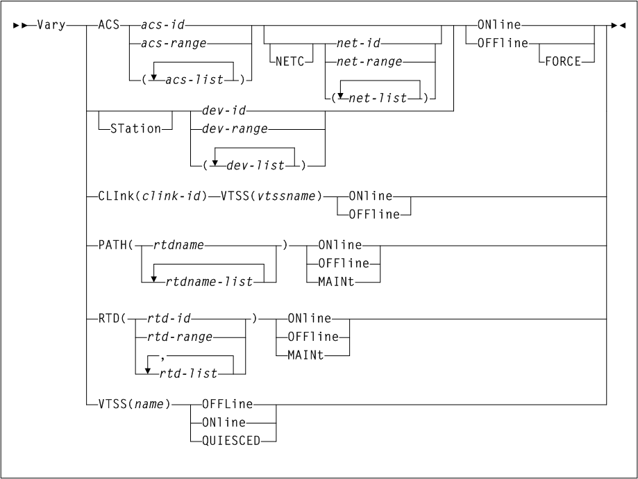

Interfaces:
Console or PARMLIB
(Vary ACS
Console or utility, UUI All (Vary CLINK
, RTD
, or VTSS
UUI Support: Yes
Subsystem Requirements:
Active HSC at FULL
service level (Vary ACS
Active HSC/VTCS (Vary CLINK
, RTD
, or VTSS
Interfaces:
Console or PARMLIB
only
UUI Support: No
Active HSC at FULL
service level
