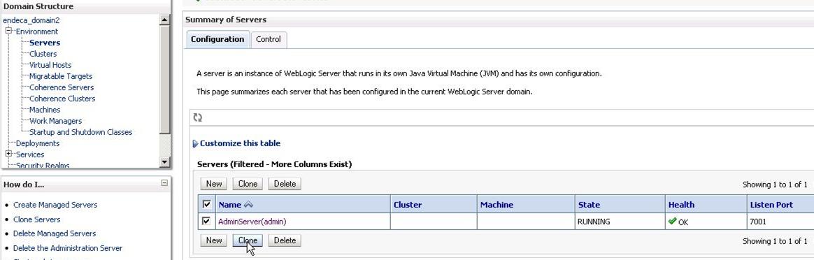

To create an Admin Server, generate SSL certificates for the Endeca Server on it, and create Managed Servers, do the following:
See Creating the WebLogic domain for Endeca Server.
This procedure assumes that you have created a WebLogic domain endeca_server_domain. Once you create this domain, the only machine that is currently configured in it becomes the Admin Server.

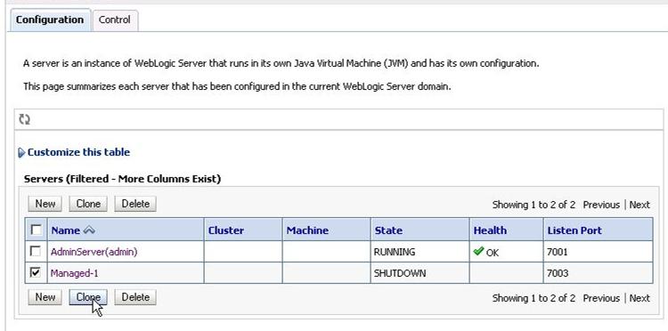

The Clone option is activated.

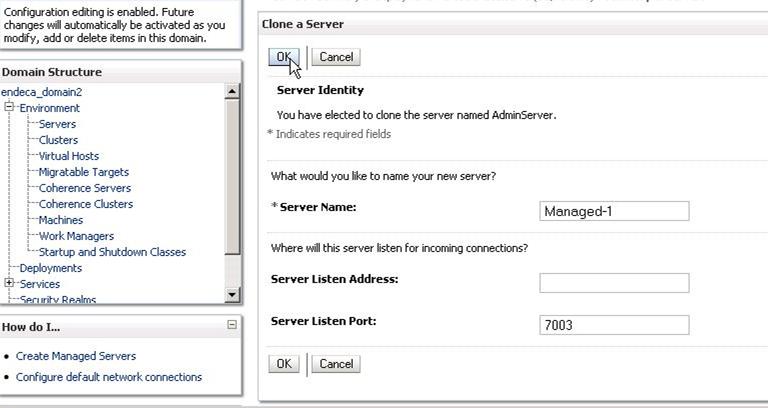

The next window opens.

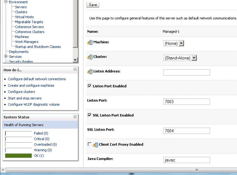

The server named Managed-1 is created, but its SSL Listen Port must be enabled and specified.
