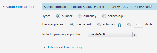

  1. To customize the display of a numeric value:
    Value Formatting fields for a numeric value

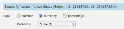

    1. If the number is formatted by default as a regular number, then you can change the display to be a currency value or a percentage.
      To change the type of formatting for a number, click the radio button next to the formatting type to use.
      If the number is formatted by default as a currency or a percentage, then you cannot select a different type of number formatting.
    2. If you have changed the formatting of a number to be a currency value, then from the Currency drop-down list, select the type of currency.
      Currency selection drop-down list for a currency value
      If the number was originally formatted as a currency, then the currency selection is displayed as a read-only value.
    3. If the number is a percentage, then from the Include percentage sign drop-down list, select whether to display the percentage (%) sign with the value.
      Include percentage sign drop-down list for a percentage value
    4. Under Decimal places, to use the decimal place configuration from the View Manager, leave the use default radio button selected.
      To display the full raw number if possible, click the automatic radio button. For extremely long numbers, Studio may still need to truncate the decimal places.
      To specify the number of decimal places, click the custom radio button, then in the field, type the number of decimal places to display.
    5. From the Include grouping separator drop-down list, select whether to display the grouping separator (used to separate thousands).

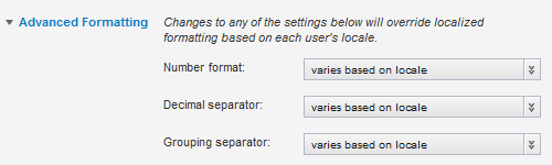

  2. For numeric values, the Advanced Formatting section provides additional format options. To display those options, click the section heading.
    For each of the advanced items, you can choose to have the display use the default configured for the view, or select a specific option for this particular component. Under Advanced Formatting:
    Advanced Formatting options for a numeric value
    1. From the Number format drop-down list, select how to display negative numbers.
    2. From the Decimal separator drop-down list, select the character to use for the decimal point.
    3. From the Grouping separator drop-down list, select the character to use for the grouping (thousands) separator.

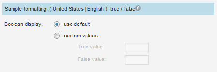

  3. For a Boolean attribute, to set the values to display for each Boolean value:
    Value Formatting fields for a Boolean value
    1. Click the custom values radio button.
    2. In the True valuefield, type the value to display if the attribute value is 1 (True).
    3. In the False value field, type the value to display if the attribute value is 0 (False).

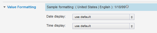

  5. For a date/time attribute:
    Value Formatting fields for a date/time attribute
    1. From the Date display drop-down list, select the format to use for the date.
      For each format, the display is controlled by the locale. For example, for some locales, the month is displayed first, and for others the day is displayed first.
    2. From the Time display drop-down list, select the format to use for the time.

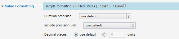

  7. For a duration attribute:
    Value Formatting fields for a duration attribute
    1. From the Duration precision drop-down list, select the unit to use when displaying the duration.
      For example, for a duration of 1 day, 15 hours, and 20 minutes, if you choose days as the precision, the value displays as 1.63 days. If you choose hours, the value displays as 39.33 hours.
    2. From the Include precision unit drop-down list, select whether to display the precision unit next to the value.
    3. Under Decimal places, to specify the number of decimal places to display for the duration value, check the custom checkbox, then enter the number in the field.
