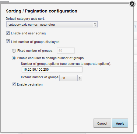

  1. On the Chart Configuration tab, click Sort options.
  2. From the default sort drop-down list, select the default sort order. The default includes both the item to sort by and whether to sort in ascending or descending order.
    Sorting configuration dialog for a chart with the end user sorting enabled

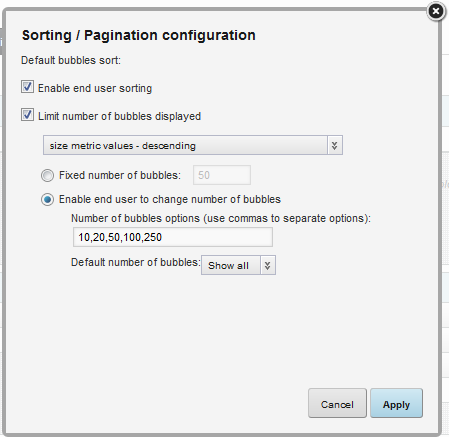

    Note that for bubble charts, the drop-down list is only enabled if you are limiting the number of bubbles to display. If you do not limit the number of bubbles, then the chart is automatically sorted using the size metric value in descending order.
    Sorting configuration dialog for a Bubble chart
  3. To allow end users to change the sort order, check the Enable end user sorting checkbox.
  4. To limit the number of results displayed on the chart at a time, check the limit number displayed checkbox.
    If the box is checked, then the remaining pagination settings are enabled.
  5. If you are limiting the number of results displayed at a time, then to not allow users to change the displayed number of items:
    1. Click the Fixed number radio button.
    2. In the field, type the number of results.
  6. To provide a list of options for users to select the number of results to display per page:
    1. Click the Enable end user to change radio button.
    2. In the number of results options field, type a comma-separated list of options.
    3. From the default number of results drop-down list, select the default value to use.
  7. To save the sorting and pagination configuration, click Apply.
