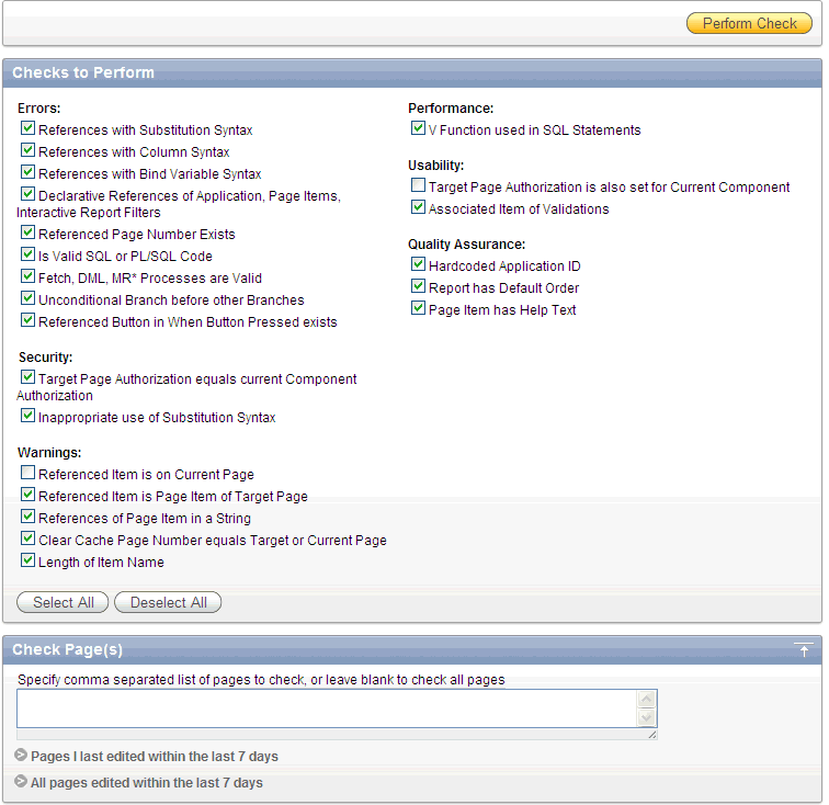

The Advisor page appears.
Under Checks to Perform, review the selected checks. Enable and disable check boxes as appropriate.
Click Perform Check at the top of the page.

To change settings, click Change Settings.
To run the check again, click Perform Check at the top of the page.
