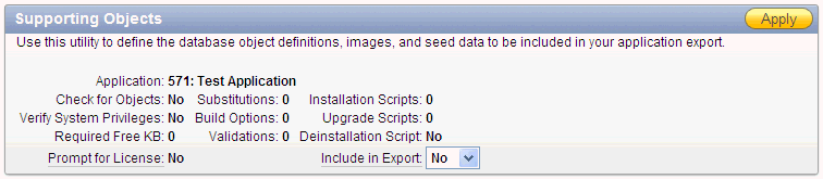

You create a packaged application on the Supporting Objects page.
To access the Supporting Objects Page application:
On the Workspace home page, click the Application Builder icon.
Select the application.
The Application home page appears.
Click the Supporting Objects icon.
The Supporting Objects page appears.
The top of the Supporting Objects page displays the application name and indicates current selections for the following: Check for Objects, Verify System Privileges, Required Free KB, Prompt for License, Substitutions, Build Options, Validations, Installation Scripts, Upgrade Scripts, Deinstallation Script, and Include in Export.
To specify whether or not to include supporting objects with an application export, select Yes or No from the Include in Export list and click Apply.
