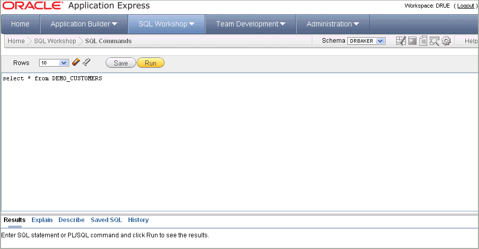

The SQL Commands home page is divided into two sections: a command editor and a display pane. You use the command editor to execute SQL commands and the display pane to view output, saved command lists, and history lists.
The top of the SQL Commands home page features a command editor and the following controls:
Autocommit. If available, click the Autocommit check box to enable autocommit and disable transactional commands. See "About Transactions in SQL Commands".
Rows. Select the number of rows of output to display simultaneously up to a maximum of 100,000. All rows of DBMS Output are displayed regardless of the Display list setting.
Clear Command icon. The Clear Command icon resembles a pencil with an eraser. Use this icon to clear the text in the command editor.
Find Tables icon. The Find Tables icon resembles a flashlight. Click this icon to view tables within the currently selected schema. See "Using the Find Tables Icon".
Save. Click the Save button to save the contents of the command editor, or the currently highlighted content to a file. You are prompted to enter a name and an optional description. The command appears in the Saved SQL list. See "Saving an SQL Command".
Run. Click the Run button to run the command in the command editor, or the currently highlighted command in the command editor. See "Running a SQL Command".

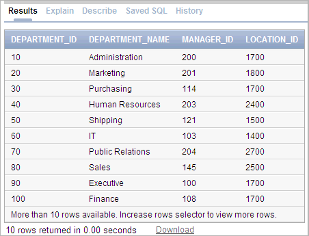

Results. Click the Results tab to see the results from the last successfully executed SQL command. Click DBMS Output at the bottom of the displayed results to display lines of DBMS output. This control only appears when there is DBMS output to display. Click Download to export results to a comma-delimited file on your local file system. See "Viewing Results".

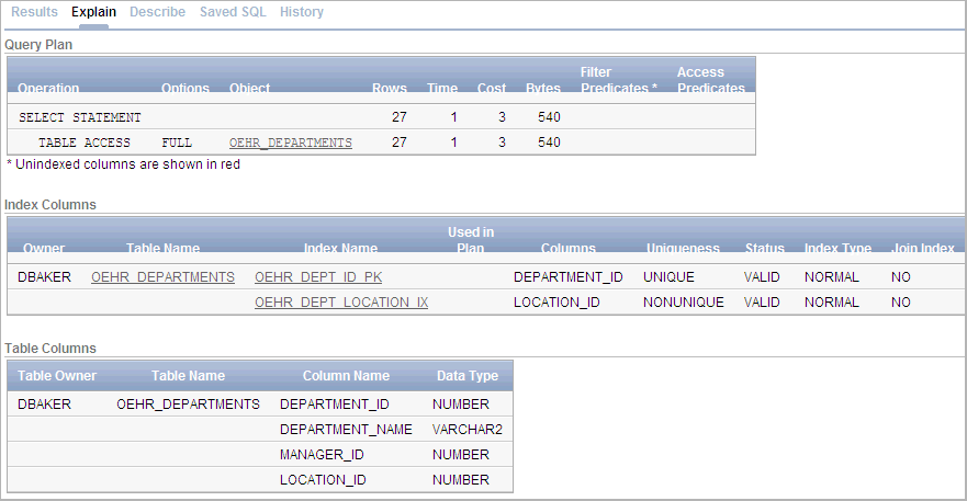

Explain. Click the Explain tab to examine the execution plan used by the optimizer for statements that make changes to the database. Objects in the output are linked to the Object Browser. Click the linked object to view its properties in the Object Browser. See "Using Explain Plan".

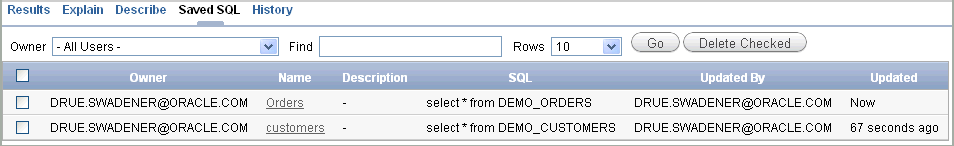

Saved SQL. Click the Saved SQL tab to display a list of all SQL commands saved in the current workspace. Click the command title to load it into the command editor. See "Using Saved Commands"

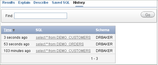

History. Click the History tab to list your recently executed commands. Your last 200 executed commands are saved. See "Using SQL Command History".

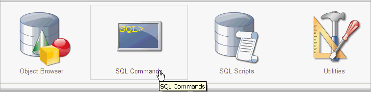

Switching to Another SQL Workshop Component
You can navigate to another SQL Workshop component by making a selection from the Component list located on the upper right side of the page.
Available icons include:
Object Browser. See "Managing Database Objects with Object Browser".
SQL Commands. See "Using SQL Commands".
SQL Scripts. See "Using SQL Scripts".
Query Builder. See "Building SQL Queries with Query Builder".
Utilities. See "Using Oracle Application Express Utilities".
You use the command editor in SQL Commands to execute SQL commands within Oracle Application Express.
To execute a SQL Command:
On the Workspace home page, click SQL Workshop and then SQL Commands.
The SQL Commands page appears.
Enter the SQL command you want to run in the command editor.
Click Run (Ctrl+Enter) to execute the command.
Tip:
To execute a specific statement, select the statement you want to run and click Run.The results appear in the Results pane.

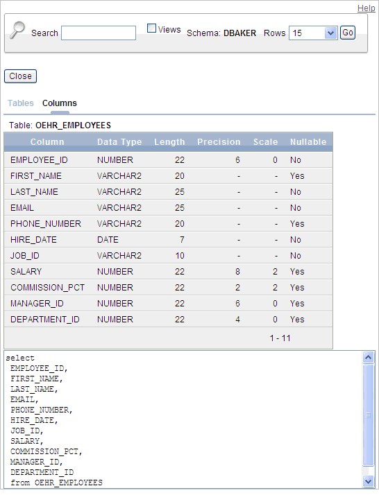

To view tables within the current schema:
Navigate to SQL Commands.
From the Schema list, select a schema (optional).
Click the Find Tables icon.
The Table Finder appears. A search bar displaying the selected schema displays at the top of the page and contains the following controls:
Search. Search for a table name. Enter case insensitive keywords in the Search field and click Go. To view all tables, leave the Search field blank and click Go.
Views. Select the Views check box and click Go to include views in the resulting report.
Rows. Determine how many rows display in the resulting report. To change the number of rows that display, make a selection from the list and click Go.
The Table Finder report appears displaying the table name, the number of rows, last analyzed date, and the object type.
Select a table name.
The Table Finder report appears.
This report displays the column names, data type, length, precision, scale and the SQL necessary to re-create the table that appears at the bottom of the page.

When you execute a SQL command, the results are displayed. The results of the last executed command are available until you execute another SQL command, or leave SQL Commands.
To display SQL command results:
Click the Results tab.
The HTML formatted results appear in the display pane.
Click DBMS Output to display plain text DBMS output results.
The DBMS Output control only appears if there is DBMS output results.
The Results pane displays SQL command results as HTML formatted table. The number of rows returned appears after the output, and the time taken. DBMS output appears as plain text after the HTML formatted results.
On the Results pane you can:
Display DBMS output. Automatically displays HTML output or DBMS output depending on type of SQL command entered, SQL or PL/SQL block with DBMS output.
Export results. Click Download to export results to a comma-delimited file on your local file system. You are prompted to enter a name and directory for the file. Only available for HTML output.
You can view the explain plan the Oracle Optimizer uses to run your SQL command. It is not necessary to execute the command to view the explain plan.
To view the Explain Plan:
Enter or load the command whose plan you want to view.
Click the Explain tab.
The explain plan used by the optimizer appears in the display pane.
The Explain Plan pane shows the plan used by the Oracle Optimizer to run your SQL command. It typically displays the Query Plan, Index Columns and Table Columns used.
On the Explain Plan pane you can:
View object definitions. Click the object name in Query Plan to display the object definition in the Object Browser.
View index definitions. Click the index name in Table Columns to display the index definition in the Object Browser.
You can access the commands you save and commands saved by other users in the same workspace. You can also access SQL commands you and other users of the same workspace saved from the Query Builder.
To access saved SQL commands:
Click the Saved SQL tab.
The Saved SQL list of commands appears in the display pane.
Click the title of the command to load it into the command editor.
The command appears in the editor.
Click Run to execute the command.
The Saved SQL pane displays a list of all commands saved under the current workspace. The list displays commands saved from SQL Commands and SQL commands saved from Query Builder. Saved SQL commands must have unique names in the current workspace. The same name cannot be used in the Query Builder and SQL Commands.
Each command entry shows the owner name, the command name, a description if it exists, the first characters of the SQL command, who last updated the command and when.
On the Saved SQL pane you can:
Show commands by owner. Make a selection from the Owner list to specify the user whose commands you want to display. To view all scripts select -All Users-.
Search for a command. Enter a command name or partial name, or enter a code snippet in the Find field and click Go. To view all scripts, leave the Find field blank and click Go. You control how many rows display by making a selection from the Rows list.
Set the Number of Output Rows. Make a selection from the Display list to specify the number of Saved SQL commands to display simultaneously.
Delete a command. Click the check box associated with a command and click Delete Checked.
Sort commands. Click a column heading to sort the listed commands by that column.
Commands you have executed are stored in the command history regardless of whether you explicitly save them. You use SQL Command History to access commands you have executed in SQL Commands.
To access history commands:
Click the History tab.
The list of commands in History appears in the display pane.
Click the partial command displayed in the SQL column.
The History pane displays a list of commands you have executed.
Each history entry shows the time the command was last executed, the first characters of the command, and the schema in which it was executed.
On the History pane you can:
Load a command. Click the partial command displayed in the SQL column to load the command into the command editor. When the command loads, it also sets the schema in which it was last executed.
Sort by time. Click the Time column heading to sort the command history by least recent or most recent.
