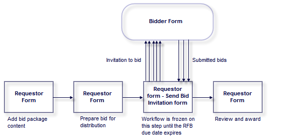

Following is an example of a workflow for a bid invitation:

Once the bid invitations have been sent, the user must wait for the bid due date to pass. |
