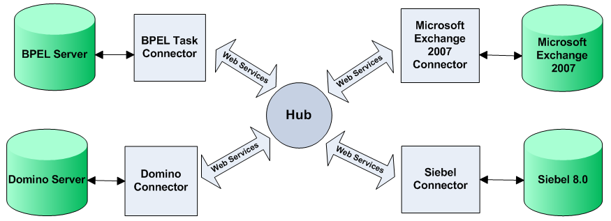

Oracle Business Data Synchronization Server (BDSS) utilizes a hub-and-spoke architecture that enables synchronization between PIM servers. The hub provides the core synchronization functions and is PIM-server agnostic, enabling connections for any type of PIM server. Connectors, which send data to and retrieve data from the PIM servers, comprise the spokes of the system. Figure 2-1 illustrates an example of this architecture, one that results in fewer connectors between PIM servers. Even in multiserver topologies, this simpler synchronization topology addresses the potential issue of data feedback looping between the PIM servers.
Figure 2-1 An Example of the BDSS Hub-and-Spoke Architecture
Hub-and-spoke architecture
For Oracle Fusion Middleware 11g release 2, BDSS ships with support for Microsoft Exchange.
