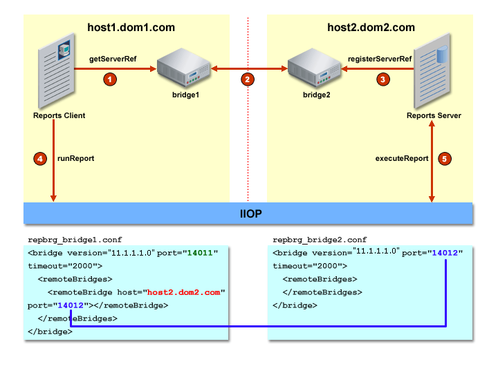

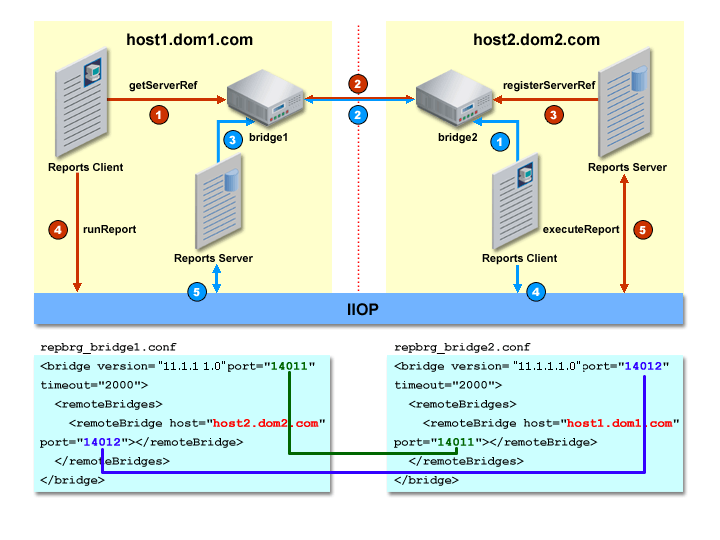

If you specify the optional remoteBridge
element(s) in the repbrg_
bridgename
.conf
, then the bridge will act as a two-way bridge. That is, the bridge can get server references from remote bridges.
Figure 7-2 Oracle Reports Bridge Configuration (One-Way)
If you do not specify the optional remoteBridge
bridgename
.conf
, then the bridge will act as a one-way bridge. That is, the bridge can only serve remote bridges. It cannot connect to remote bridges to get the server reference.
