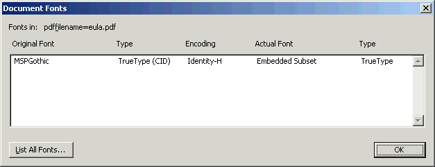

You can view the fonts used in your reports as follows:
In Acrobat Reader 6.0 and later, choose File > Document Properties > Fonts. (In prior releases, beginning with Acrobat Reader 3.0, choose File > Document Info > Fonts.)
The Document Font dialog box displays Original Font, Type, Encoding, Actual Font (or the font used), and Type.
In the case of font subsetting:The Encoding column will display Identity-H.
The Actual Font column will display Embedded Subset.
The Type column will display TrueType.
