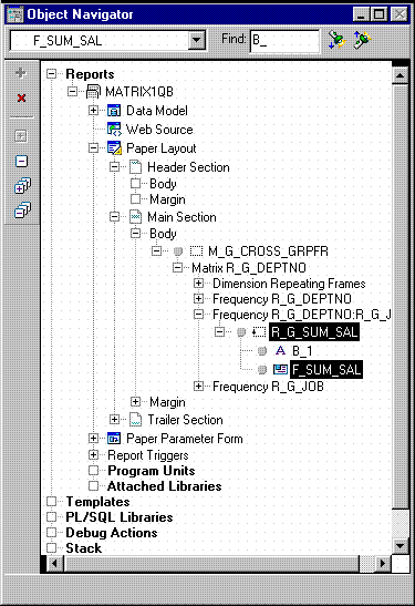

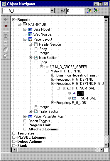

In the Object Navigator, type B_1 in the Find field. You will be taken to the object you just created. If you are viewing the Object Navigator in Ownership View (View > Change View > Ownership View), you should see B_1 underneath R_G_SUM_SAL and on the same level as F_SUM_SAL.
Tip:
If B_1 does not appear underneath R_G_SUM_SAL, return to the Paper Layout view, delete B_1 and try again.Figure 25-10 Object Navigator with new object selected
Click R_G_SUM_SAL and then ctrl-click F_SUM_SAL so that they are both selected and B_1 is deselected.
Figure 25-11 Object Navigator with repeating frame and field selected

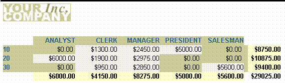

If the $0.00 is not quite aligning with the other monetary values around it, select it and use the arrow keys to move it to the desired location.Figure 25-12 Matrix report output with zeroes replacing blanks
