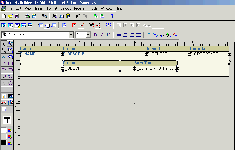

Using the toolbar along the top of the Paper Layout view, turn Flex Mode off.
Using the arrow keys, move M_G_CUSTID1_GRPFR1 and its contents inside of the first layout.
Figure 13-8 Paper Layout view with two layouts merged into one

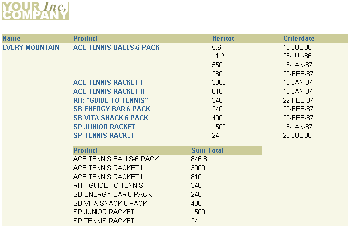

Click the Paper Design button in the toolbar of the Report Editor to display the Paper Layout view. Notice how the summary table now repeats for each customer.
Figure 13-9 Paper Design view with two layouts merged
