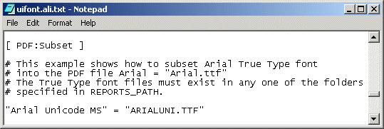

Back up your registry before editing it as working with registry keys can cause the system to become unstable.Open the uifont.ali file and edit it to specify the TrueType font file name. Type "Arial Unicode MS" = "ARIALUNI.TTF" under the [PDF:Subset] section. After including the line, the uifont.ali file should look like:
Figure 38-3 uifont.ali file edited to include the TrueType font file name
uifont.ali file edited to include the TrueType font file name"Note:
On Windows and UNIX, theuifont.ali file is located in ORACLE_INSTANCE\config\
FRCommonComponent\frcommon\guicommon\tk\admin. The uifont.ali file defines the font aliases used by Oracle Reports and is extremely useful for cross-platform development. This file enables you to define which fonts to substitute when a particular font is unavailable. For more information, see the "Font Related Features" section in the chapter "Using PDF in Oracle Reports" in the Oracle Fusion Middleware Publishing Reports to the Web with Oracle Reports Services manual.In the Windows registry under the Oracle key and IDS_HOME, add the location of the ARIALUNI.TTF TrueType font file to the value of REPORTS_PATH. For example, C:\WINNT\Fonts.
