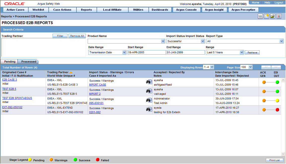

Incoming E2B Reports
Incoming E2B Reports can be viewed from the Incoming E2B Report screen. This section includes discussions on the following:
Searching for Duplicate Cases
The Duplicate Search dialog for E2B report allows you to search for possible duplicate cases in the Argus Safety system. You can select different combinations of search criteria. When more than one criterion is selected, only cases that satisfy all criteria are listed. By default, only the fields that are present in the E2B Report are checked for the Duplicate Search.
Use the following procedure to perform a duplicate search.
  1. Select Reports -> E2B Pending Report.
  2. When the system opens the Incoming E2B Reports dialog, right-click a case to perform a duplicate search.
  3. The system displays the search results at the bottom of the dialog box.

Processed E2B Reports
The Processed E2B Reports screen contains a list all processed E2B Reports. Click the Processed E2B Reports tab on the Incoming Reports screen to view the Processed E2B Reports screen.
Surrounding text describes procsdreps.gif.
The Processed E2B screen contains the following:
The following table lists and describes the fields in the Total Number of Rows section on the Processed E2B screen.
Field Description
Originated Case# Displays the Originated Case Number of the case.
Initial/F-U/Nullification Displays the Initial/F-U/Nullification status.
Trading Partner The name of the trading partner.
World Wide Unique# The World Wide Unique # for the case.
Import Status - Warnings/Errors The import status of the case and any associated warnings/errors.
Case # Imported As The Case Number used when importing the case.
Accepted / Rejected By Identifies who accepted or rejected the case.
Notes The case notes.
Interchange Date The Interchange Date.
Date Imported/Rejected The date the case was imported/rejected.
ACK Gen Yellow indicates the case is still pending
Orange indicates the case is accepted with warnings / errors
Red indicates the user or system rejected the case.
Green indicates the case has been successfully imported.
EDI Out Yellow indicates the system is waiting to send the report out of the EDI / XML or PHY out folders
Green indicates the report is already sent out of the EDI / XML or PHY out folders
Red indicates that the EDI gateway failed to send the report out of the EDI / XML or PHY out folders.
