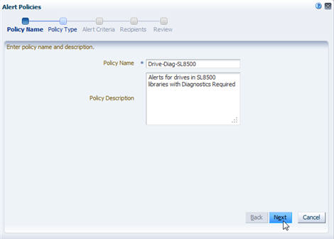

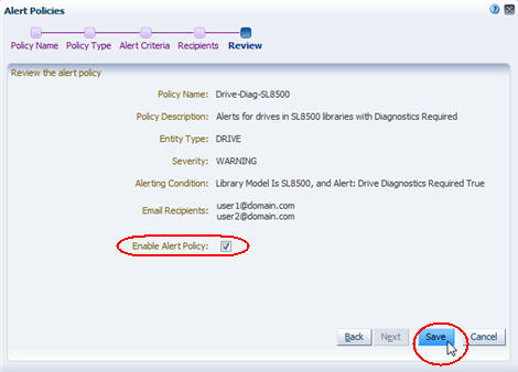

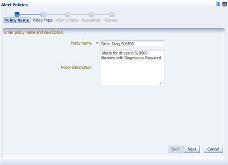

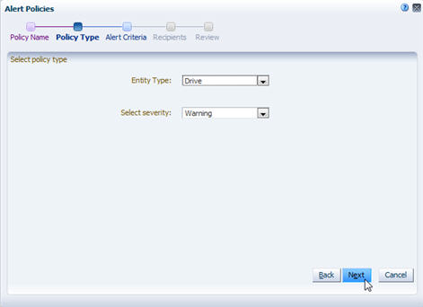

When you create an alert policy, you can enable it immediately or leave it disabled for the time being. In addition, several sample alert policies are delivered with STA, and they are disabled by default (see "STA Sample Alert Policies" for details). Only enabled alert policies are used to generate alerts.

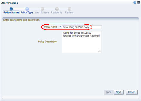

To define an alert policy you specify the following information:
Policy name – An alphanumeric identifier for the policy. Policy names must be unique.
Policy description – Optional description of the policy.
Entity type – Entities are tape library system resources or events. You must designate the types of entities to be evaluated by the alert policy. Options include libraries, drives, media, exchanges, and media validations. See "Alert Policy Entities" for a complete list.
Severity – Determines the frequency with which alerts may be generated whenever the criteria defined by this policy are met. See "Alert Policy Severities" for details.

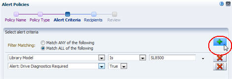

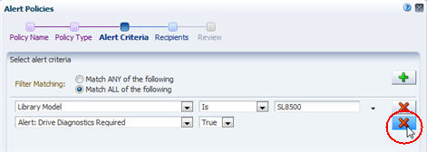

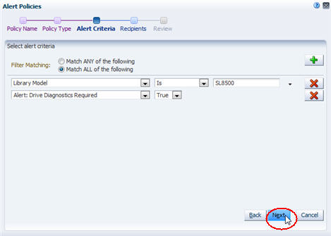

Alert criteria – User-defined criteria by which the appropriate library system resources are evaluated. Alert criteria work in much same way as the STA filtering feature. See "Filter Data Dialog Box" for details.

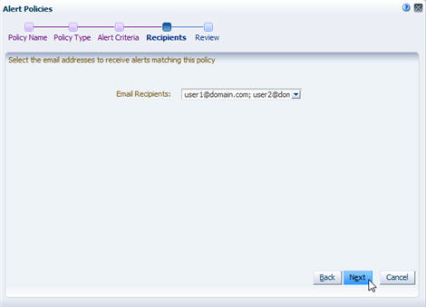

Email recipients – Optional list of email addresses to receive emails whenever an alert is generated by the policy. See "Alert Emails" for details.

If the alert policy includes email addresses, an email containing details about the alert is sent to the designated addresses. See "Alert Emails" for details.

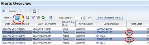

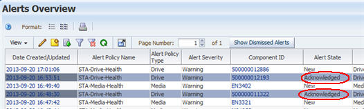

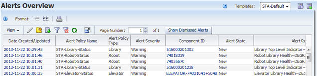

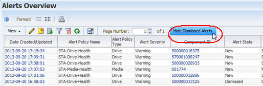

Any STA user can perform this part of the process from the Alerts Overview screen on the Tape System Activity tab.
The screen displays a list of generated alerts, and you can sort, filter, export, and print this list according to your needs. Users with Operator privileges can also annotate selected alerts.
If you are using an alerts workflow at your site, you can update the state of selected alerts to reflect current progress. Alerts workflow management is an optional manual process. See "Alerts Workflow" for details.

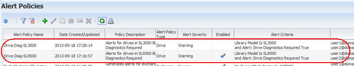

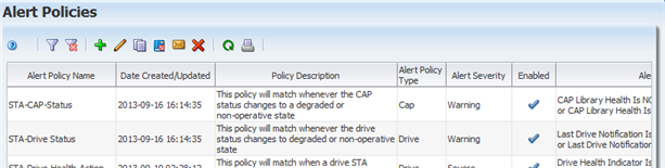

Table 5-1 summarizes the alert policy definition activities available to each STA user role.
Table 5-1 Alert Policy User Roles
| User Role | Alert Policy Activity | Screen |
Operator and above |
Display, filter, and print a list of defined alert policies. |
Setup & Administration > Alerts Policies |
Administrator only |
Define an alert policy. Copy an alert policy. Rename a policy. Change the policy criteria. Change the list of email recipients. Enable or disable an alert policy. Delete an alert policy. |

In the Navigation Bar, select Setup & Administration > Alerts Policies.
The Alerts Policies screen appears, showing all sample and user-defined policies at your site.
You can manage the list of alert policies by performing the following tasks:
Filter the table records; see "Use the Filter Data Dialog Box to Change a Table Filter".
Reset a filter applied to the table; see "Clear the Current Filter".
Refresh the table to display new policies; see the STA Screen Basics Guide.
Display a printable form of the table in a separate browser tab or window; see the STA Screen Basics Guide.

Complete the first screen of the wizard as follows:
In the Policy Name field, type a unique name.
Your entry can include any alphanumeric characters up to 250 characters in length.
Note: All sample alert policies delivered with STA have names beginning with "STA," so it is recommended that the names you assign to your alert policies not start with this prefix. |
In the Policy Description field, enter an optional description of the policy. This information is included in alert emails. You may want to use this field to specify recommended corrective actions for alerts generated by this policy.
Click Next.
Note: On any screen of the wizard, you can select the breadcrumb links at the top of the dialog box to go directly to the next immediate screen or any screen you have already visited.![]() |
Complete the second screen of the wizard as follows:
In the Entity Type menu, select the type of library system component for which this policy may generate alerts. See "Alert Policy Entities" for information about the types.
In the Select Severity field, select the severity level of the alert policy. See "Alert Policy Severities" for information about severity levels.
Click Next.
On the third screen of the wizard, specify the alert policy criteria as follows:
In the Filter Matching field, indicate whether you want to match any or all of the criteria you specify.
Click the Add New Filter Criteria Row button to add a new, blank selection criteria row to the dialog box.
Specify the selection criteria using the menus and text fields on the row. See Table 4-1, "Filter Operators by Attribute Type" for details on completing each row.
Note: When selecting an attribute for filtering, if you know the name of the attribute you want to select, you can type the first few letters to quickly move the cursor to that item in the menu. |
You can add as many rows of selection criteria as you want.
Note: When basing selection criteria on logical groups, it is usually appropriate to use the "Contains" and "Doesn't Contain" operators, rather than the "Is" and "Isn't" operators. This is because drives and media can belong to more than one logical group at a time. See "Filtering by Logical Group" for details. |
To remove criteria, click the Remove This Filter Criteria Row button on the row you want to delete.
Verify that your criteria are correct and click Next.

Complete the fourth screen of the wizard as follows:
In the Email Recipients menu, select the email addresses to which you want emails to be sent whenever an alert is generated by this policy.
Click Next.
Complete the last screen of the wizard as follows:
Verify that all the policy information is correct.
Use the Enable Alert Policy check box as follows:
Select the check box to create the policy and enable it immediately.
Deselect the check box to create the policy but leave it disabled for now. You can enable it at a later time. See "Enable or Disable an Alert Policy" for details.
Click Save.
The policy is created. If the policy is enabled, then the appropriate library system resources are immediately evaluated against the policy and alerts are generated as appropriate. If the policy is disabled, then the policy is not evaluated for now.

Select the alert policy you want to copy and click Copy Alert Policy.
The first screen of the Alert Policies wizard appears. The copy of the policy has all the same information as the original, except for the following:
The word "Copy" is added to the end of the Policy Name.
No email recipients are defined.
The policy is disabled (the Enable Alert Policy check box is deselected).
In the Policy Name field, type the name you want to assign.
Use the Next button or the wizard breadcrumbs at the top of the dialog box to navigate to the screens with the information you want to modify. See "Create an Alert Policy" for details on completing these screens. You can also leave all information unchanged if you are simply copying the original policy to preserve it.
Click Save when done.
The new policy is created, and the Alerts Policies screen is updated with the information.
In the following example, the Drive-Diag-SL3000 policy was copied from the Drive-Diag-SL8500 policy, and the alert criteria were modified to evaluate drives in SL3000 libraries.

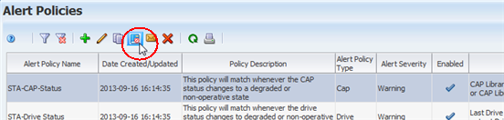

Select the policy you want to modify.
If the policy is currently enabled, the Disable Alert Policy icon in the Alerts Policies toolbar becomes active. If the policy is currently disabled, the Enable Alert Policy icon becomes active.
Click Enable/Disable Alert Policy.
The policy is updated according to your selection.

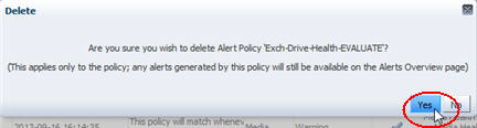

Select the alert policy you want to delete and click Delete Alert Policy.
The Delete dialog box appears.
Verify your selection and Click Yes to confirm the deletion.
The policy is deleted and the list on the Alerts Policies screen is updated.

In the Navigation Bar, select Tape System Activity > Alerts Overview.
The Alerts Overview screen appears, showing all active (not dismissed) alerts that have been generated to-date.

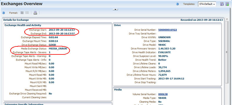

Select the alerts you want to view and click Detail View.

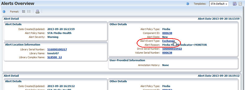

In the Detail View, each record you have selected includes several links to other screens containing related information.
Select the link in the Alert Event Type field (in this example, Exchange) to display detail for the event that triggered the alert.
You can use the information that is displayed to trace the cause of the alert and determine whether you need to take any action.
Use this procedure to change the state of selected alerts according to the alerts workflow process implemented at your site. See "Alerts Workflow" for details on this process.
Note: This procedure can be performed by any STA user with Viewer privileges or above. |
The Alerts Overview screen appears.
Select the alerts you want to modify and click Change Alert State. You can select multiple alerts.
The Change Alert State dialog box appears.
In the menu, select the state you want to assign to the selected alerts. You can assign any available state, and then click OK.
The alerts are updated, and their new state is displayed in the Alerts Overview screen.

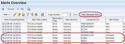

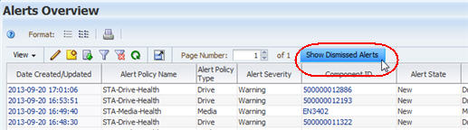

The Alerts Overview screen appears, and by default, all dismissed alerts are hidden from view.
Click the Show Dismissed Alerts button in the table toolbar.
Dismissed alerts are now visible on the screen, and the button label has changed to Hide Dismissed Alerts.
To hide the dismissed alerts again, click the Hide Dismissed Alerts button.
