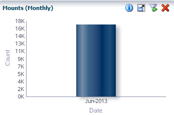

Times Displayed on the Dashboard
Because the Dashboard reports high-level summaries for your entire tape library system, all data is reported in UTC time. In contrast, all other STA screens report times adjusted for your local time zone (as specified in the time zone preferences for your STA username; see theSTA User’s Guide for details).
In the sample Maximum Mount Time (Hourly) graph below, the selected mount shows a date and time of 3/18/14 9:00 AM. However, if you were to view this mount on the Exchanges Overview screen, the date and time would be adjusted to your time zone preference. For example, if your preference setting were UTC-5, the selected mount would show a date and time of 3/18/14 4:00 AM.on the Exchanges Overview screen.
Description of if_dashutc.png follows

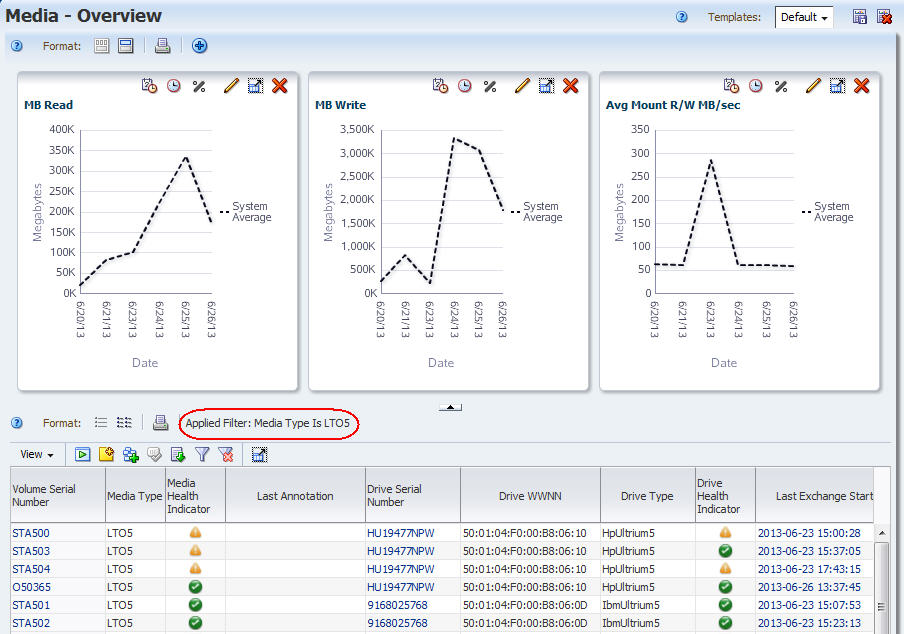

Linking to Detail Screens
Some Dashboard portlets provide links to other STA screens, allowing you to drill down to more detail about the selected resources. See "Filtering Using Dashboard Graphics" and "Apply a Filter From the Dashboard" for additional information.
Graph Links
Bar charts, pie charts, and area charts bring up the List View for the selected resource, with a filter applied to the screen display. The following screens show how clicking on a pie chart section brings up the Media – Overview screen List View, filtered to show only the selected media type.
Description of if_dashpielinkfr.jpg follows
Description of if_dashpielinkto.jpg follows
Some graph sections may not have associated Overview screen information to display. For example, in the Library Media Slots portlet below, there is no media detail available for the Unallocated category, which represents media slots that are empty or not activated. Therefore, clicking on this section of the pie has no effect.
Surrounding text describes if_dashpienolink.png.

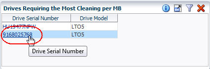

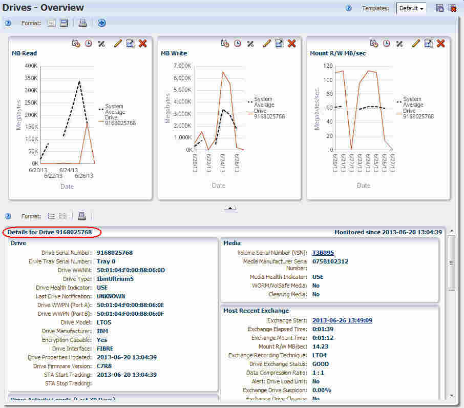

Text Links
Some table portlets include text links, which bring up the Detail View for the selected resource. The following screens show how the drive serial number link on a Dashboard portlet brings up the Drives – Overview screen Detail View for the selected drive. See the STA Screen Basics Guide for additional information on text links.
Description of if_dashtablelinkfr.jpg follows
Description of if_dashtablelinkto.jpg follows

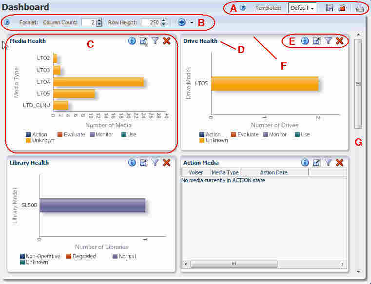

Dashboard Layout
The Dashboard is divided into equal-sized portlets that are arranged in columns and rows. There can be from one to five columns, and any number of rows. Rows can be 100 to 600 pixels in height.
Description of if_dashlayout.jpg follows
Item Name Description
A Template Toolbar Provides direct access to commands for applying and managing templates. This toolbar appears on most STA screens. See "Templates Toolbar" for details.
B Dashboard Toolbar Provides direct access to commands for managing the Dashboard display. See "Dashboard Toolbar" for descriptions of each icon.
C Dashboard portlet Dashboard portlets are arranged in columns and rows. Each portlet shows a different high-level view of your tape library system. See "Dashboard Portlets" for details.
D Dashboard portlet title Identifies the type of data in the portlet. See "Dashboard Portlets" for details.
E Dashboard portlet toolbar Provides direct access to commands for manipulating the display of this Dashboard portlet. See "Dashboard Portlet Toolbar" for details.
F Dashboard portlet border Shaded area at the top of the Dashboard portlet. Allows you to grab the portlet and move it. See the STA Screen Basics Guide for details.
G Vertical scrollbar Appears only if there are additional rows below the bottom of the screen.

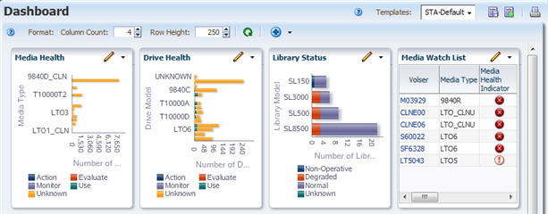

Dashboard Toolbar
The Dashboard Toolbar appears at the top of the Dashboard. It provides direct access to frequently used commands for controlling the overall display of the Dashboard.
Description of if_dashtoolbar.jpg follows
Icon Name Description
Help icon
Help Displays help for the Dashboard.
Related Topic: "Help"
Column Count field
Column Count Displays the number of columns in the Dashboard display and allows you to change it.
Related Topic: "Change the Dashboard Column and Row Layout"
Row Height field
Row Height Displays the height of each Dashboard row, in pixels, and allows you to change it.
Add Pane menu
Add Portlet menu Menu provides options for you to add selected graph, table, or report portlets to the Dashboard display.
Related Topic: "Add a Dashboard Portlet"

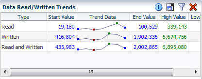

Table Portlets
The following types of table portlets are available. See "Table Portlets" for descriptions of individual portlets.

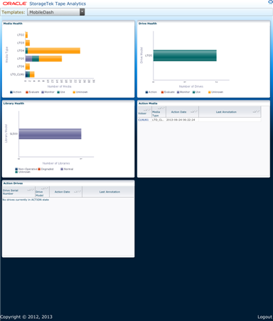

Mobile Dashboard Display
STA supports the Dashboard display on mobile devices. You can display any Dashboard template available to your STA username. Regardless of your user role, however, the mobile display is read-only. You cannot link to other screens from the Dashboard nor can you rearrange portlets and save templates. Therefore, Dashboard templates accessed from a mobile device must first be created through a desktop STA connection.
The Dashboard display is automatically optimized for your mobile device. For example, a three-column template may display in single column on a mobile phone but two columns on a tablet. Device rotation is also supported. See Figure 2-1 and Figure 2-2 for sample Dashboard displays.
Figure 2-1 Sample Mobile Dashboard Display on a Tablet
Description of Figure 2-1 follows
Description of "Figure 2-1 Sample Mobile Dashboard Display on a Tablet"
Figure 2-2 Sample Mobile Dashboard Display on a Mobile Phone
Description of Figure 2-2 follows
Description of "Figure 2-2 Sample Mobile Dashboard Display on a Mobile Phone"

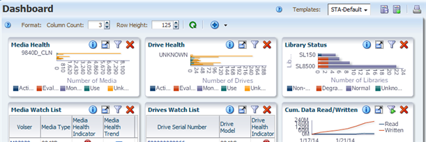

You can change the size of the individual Dashboard portlets by modifying the column count and row height.
  1. In the Navigation Bar, select Home > Dashboard. Description of if_navdash.png follows
    The default Dashboard for your STA username is displayed.
  2. To change the number of portlet columns, and therefore the width of each portlet, enter a number in the Column Count field in the Dashboard toolbar. You can also use the spinbox control arrows to change the field value. Valid entries are 1 to 5. Description of if_dashcolcountchg.png follows
    The change takes effect as soon as you press Enter or move the cursor to another area of the screen. Description of if_dashcolcountdone.png follows
    If you increase the number of columns, the Dashboard Portlet toolbars may be truncated due to lack of space. Any hidden icons are available from the menu at the far-right of the toolbar. Menu on the Dashboard Portlet toolbar
  3. To change the height of each portlet, enter a number in the Row Height field in the Dashboard toolbar. You can also use the spinbox control arrows to change the field value. Valid entries are 100 to 600. Description of if_dashrowheightchg.png follows
    The change takes effect as soon as you press Enter or move the cursor to another area of the screen. Description of if_dashrowheightdone.png follows

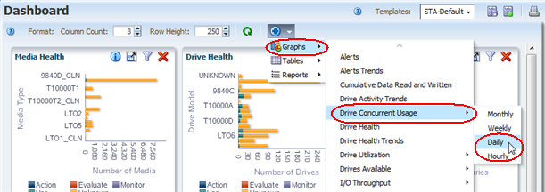

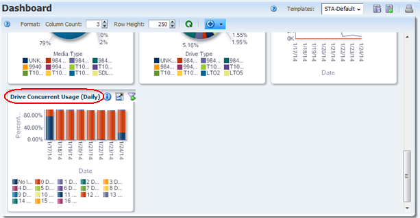

Use this procedure to add a portlet to the Dashboard display. You can include a maximum of 30 portlets.
You can add more than one instance of the same type of portlet, and you can filter each instance differently so you can focus on different data. For example, you may want to add two separate Media Health portlets: one for big libraries (SL3000 and SL8500) and one for small (SL150 and SL500).
Adding a large number of Dashboard portlets may result in the portlet legends being truncated or not displayed at all. If this occurs, you may want to remove some portlets to restore the legends.

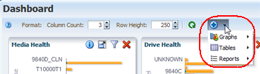

  2. In the Dashboard toolbar, select the Add Portlet menu.
    Description of if_dashaddportletmenu.png follows
    Submenus are listed for the portlet types—Graphs, Tables, or Reports.
  3. From the appropriate portlet submenu, select the specific portlet you want to add. Time-related portlets provide you with options for Monthly, Weekly, Daily, or Hourly time increments.
    Description of if_dashaddgrportlet.png follows
    The portlet is added to the end of the Dashboard display. You may need to use the vertical scrollbar to view it. To move the portlet to a new position, see the STA Screen Basics Guide.
    Description of if_dashgrportletdone.png follows

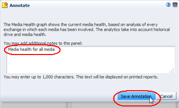

Add or Change a Dashboard Portlet Annotation
Use this procedure to add or modify a user-defined text annotation for the current portlet. The annotation appears on Executive Reports and can be used for a variety of purposes, such as clarifying the information displayed or drawing attention to specific data.
The text you enter is specific to the current Dashboard template. For example, if the Drive Health portlet appears in several Dashboard templates, each instance of the Drive Health portlet can have a different annotation associated with it.
Annotation text is specific to your STA username. For example, annotations entered by one user on the Drive Health portlet do not appear to a user logged in with a different STA username.
Annotations can be up to 1,000 ASCII characters in length. There are no formatting options, such as boldface or color. Also, spacing options, such as forced line feeds, are not preserved on the Executive Reports.
For an annotation to appear on an Executive Report, the current Dashboard view must be saved as a template. Additionally, if you modify a portlet annotation, any existing Dashboard templates using that portlet must be re-saved in order for the updated annotation to appear on Executive Reports. See "Create a Template" and "Modify a Template" for detailed instructions.
  2. Click Panel Information in the Portlet Toolbar of the Dashboard portlet you want to annotate.
    Description of if_dashportnote.png follows
    The Annotate dialog box appears.
  3. Enter the annotation text you want to appear in this instance of the portlet, and click Save Annotation to save the information. Annotations can be up to 1,000 characters in length.
    To better view the text, you can resize the dialog box by grabbing the lower-right corner of the text area and stretching it.
    Description of if_dashannotate.png follows
    Once saved, the annotation is not visible on the Dashboard portlet itself, but can be viewed by clicking Panel Information again. To have the annotation appear on an Executive Report based on this Dashboard display, you must save the display as a new template or an update to an existing template.
    Caution:
    To retain this annotation for future login sessions, you must save the current display as a template or an update to an existing template. If you log out of this session without saving the template, the annotation will be lost for future login sessions and Executive Report runs.
Apply or Change a Dashboard Portlet Filter
Use this procedure to change the data displayed on a Dashboard portlet by applying a new filter or modifying an existing one.
To remove all filter criteria from a Dashboard portlet, see "Clear a Dashboard Portlet Filter".
If a filter has been applied to a portlet, the Applied Filter icon is displayed. Some portlets are filtered by default, so they include this icon already. Hover the mouse over the icon to display a description of the applied filter.
The criteria for filtering Dashboard portlets varies by portlet type. For example, you can filter most line graphs by a date range, but you cannot do so for a pie chart.
  2. On the Dashboard Portlet toolbar of the portlet you want to modify, click Filter. If the portlet already has a filter applied, click Applied Filter.
    Description of if_dashportfilter.png follows
    The Filter Data dialog box appears. If no filter has been applied, the dialog box displays the default settings. If a filter is already in effect, the criteria are displayed in the dialog box.
    Description of if_dashportfilterbef.png follows
  3. Specify the filter criteria in the dialog box, as follows:
    1. In the Filter Matching field, select one of the options to indicate whether you want to match any or all of the criteria you specify. See "Filter Data Dialog Box" for details.
    2. Indicate the filter criteria for as many portlet attributes as you want. Click Add new filter criteria row to add more criteria.
    3. To remove filter criteria, click Remove this filter criteria row.
  4. Verify that your specifications are correct, and then click Apply.
    Description of if_dashportnewfilter.png follows
    The following updates are made to the Dashboard portlet:

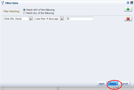

Use this procedure to remove all filter criteria from a Dashboard portlet. Unlike graph portlets on other screens, there is no Reset Filter icon available on Dashboard portlets.
To remove selected (not all) filter criteria from a Dashboard portlet, see "Apply or Change a Dashboard Portlet Filter".
  2. Click Filter Data in the Dashboard Portlet Toolbar.
    The Filter Data dialog box appears, and all selection criteria currently in effect are indicated.
  3. Click Reset.
    Description of if_dashportfilterreset.png follows
    The following updates are made to the Dashboard Portlet:
Display the Dashboard on a Mobile Device
Use this procedure to display a read-only version of the Dashboard on a mobile device, such as a mobile phone or tablet. See "Mobile Display Requirements" to verify that your device is supported.
Before performing this procedure, you must obtain access to the network on which STA is running. See "Accessing STA From Your Mobile Device" for details.
The examples in this procedure are from a mobile phone display.
  1. Start a browser window on your mobile device and log in to STA. See "Log In to STA" for details.
    The default Dashboard template for your STA username is displayed.
    Description of if_dashphonedef.png follows
  2. To change the display, select the template you want to view from the Templates menu.
    Description of if_dashtmptselphone.png follows
  3. To log out, click the Logout link at the bottom of the screen.
    Description of if_dashlophone.png follows
