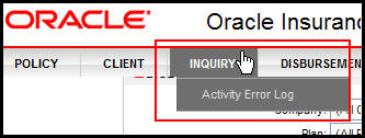

Inquiry screens configured to display on the Main Menu will appear in OIPA under the Inquiry heading on the Main Menu.
Main Menu Inquiry Screen in OIPA

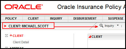

Inquiry screens configured to display at the Client level will appear in OIPA on the Client screen. The Inquiry link will appear on the Secondary Menu.
Client Level Inquiry in OIPA

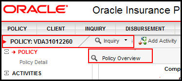

Policy level inquiries have undergone significant changes. Their contextual properties have been revised to include six new override levels, which replace prior versions’ Primary Company level. The new override levels are Subsidiary Company, Plan Group, Plan, Subsidiary Company and State, Plan Group and State, and Plan and State. Policy level inquiries do not have Global versions. Inquiry screens configured to display at the Policy level will continue to appear in OIPA on the Policy screen. The Inquiry link will appear on the Secondary Menu.
