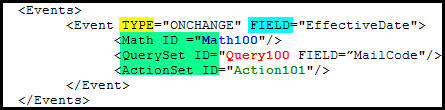

The events section identifies the type of event that needs to occur to invoke a set of actions. It also identifies the field that is connected to the event.
The available event types that can invoke an action are:
ONLOAD: runs the event on the initial load of the screen.
ONCHANGE: runs the event when a trigger field is changed. OnChange will recognize a change to the specified field's value but not a change to its currency code.
ONSUBMIT: processes the event when the final submission on the screen is selected.

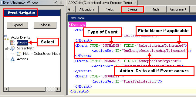

Events can be configured directly in the XML using the XML Source pane or they can be configured in the Events pane with the help of visual configuration tools. The Events pane also provides a way to see the individual parts of Events and Actions configuration without the additional transaction XML. Click an Action from the Event Navigator window to the left of the Configuration Area to add the opening tag to the configuration. If configuration already exists for the Action or Event, that configuration will display in the Event pane.
Check-out the transaction, segment or business rule's XML file.
Click the Events tab. The Event Navigator window will open.
Double-click the Events node. The opening tag for Events will display in the Configuration Area.
Configure the event. Identify the event TYPE and, if applicable, the FIELD that the event applies to.
Configure any combination of Math, ActionSets and/or QuerySets. Each action ID attribute must have a matching action.

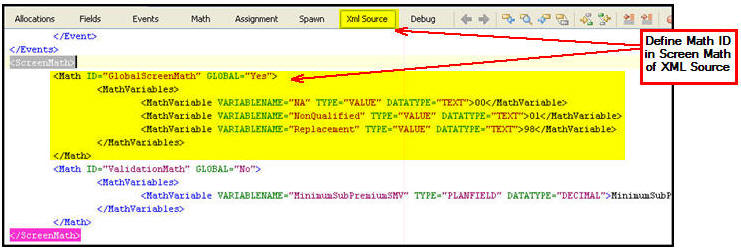

Configure the <ScreenMath> section in order to perform field math to support actions. In <ScreenMath> configure <Math> sub-elements that are each identified with an ID so that events may locate it for use. This is different from the <Math> section, because it provides the ability to perform calculations for the Fields section. ScreenMath is not available for use in the main transaction <Math> section.
The <ScreenMath> is identified through a configurable ID and can include two types of <Math>:
Global ScreenMath: All fields can use math in this section. It is only loaded on the initial load of the screen and cannot use field values.
Local ScreenMath: This is invoked when indicated by an action. Fields may be used; however, the configuror must be aware that the ScreenMath logic must be configured in such a way as to ensure that all fields being used take into consideration all of the calls to the use of the ScreenMath for that ID.
There can only be one GLOBAL ScreenMath section. The GLOBAL attribute with a value of Yes indicates to the system that the math is global. Without the GLOBAL attribute the system identities the <Math> as local. The global ScreenMath is available in the local ScreenMath section. Local ScreenMath is not available in global ScreenMath. When naming ScreenMath do not name global and local math the same. If the names are the same, the local math will take precedence.

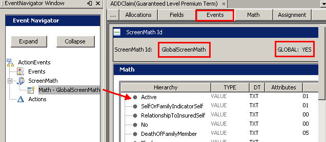

Screen Math XML
Right-click the Screen Math node and select New Math Section.
Enter the Section ID, which is the name of the ScreenMath.
Check the Global box if the math being configuring is global math.
Select Finish.
Configure the math section by dragging and dropping math variables from the Palette window.
Check-in the XML file to save the changes to the database.
Global Screen Math on Events Pane
View the ScreenMath XML from the XML Source pane. See image below.
Screen Math XML from XML Source Pane

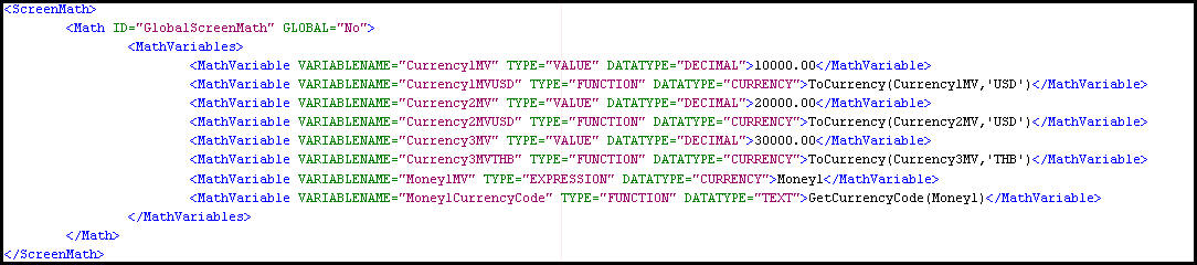

Actions can be configured to compare currency values and assign new ones to fields. Some common operations include comparing money to money fields using the less than expression, comparing currency math variables, assigning a currency code to a math variable or field and assigning a value from a money field to another with like currency codes.
Keep in mind the following points when using currency in Actions.
The Currency Code of a field can be found using the syntax of "FieldName:CurrencyCode".
The Currency Code of a math variable can be found using the function “GetCurrencyCode ()”.
Action type ASSIGN should validate the source currency code against that of the target. If the currency code of the target does not allow the currency of the source, the system will throw a stack trace indicating the currency codes are incompatible. The Currency code of the target is defined in the <Currency> element of the field or in its absence, the plan or company default currency using standard best match logic.
Action type ASSIGN will only accept Money fields or CURRENCY math variables as assignment values for Money fields.

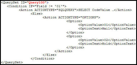

QuerySets allow combo boxes to load with a SQL statement, as well as define a set of hard coded combo box options. <QuerySet> is a sub-element of <Actions> and each <QuerySet> is identified with an ID attribute that the <Event> section uses to locate the correct configuration.
When configuring the change of combo box data, make sure to use the FIELD attribute in the corresponding <Event> section for the trigger field. In the <QuerySet> sub-element use the FIELD attribute for the field that will have its data changed.
Conditional logic can also be written in this section.

QuerySet XML
Double-click the Actions node. The XML data will open on the Configuration Area.
Configure the action by defining the QuerySets needed for the event. A sample is shown above.
