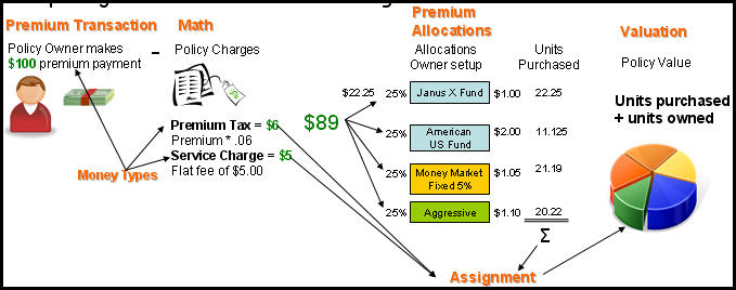

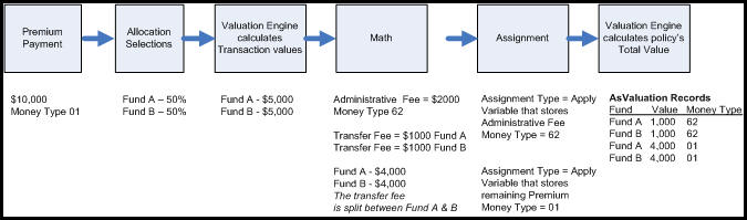

Before configuring a plan that will value policies it is important to understand how OIPA processes values. The OIPA code will perform hard coded calculations depending on the type of funds being used for valuation. OIPA will also perform certain predefined steps when valuation is run. This is known as running the valuation engine.
A transaction may be configured to execute or not execute the valuation engine. Upon execution of the valuation engine, the OIPA system gathers the fund information needed to perform the valuation steps. The information gathered is dependent on the use of Point-In-Time valuation or Traditional valuation.
With both methods now at a similar point, fund and deposit values are calculated to the current valuation date. Results of the calculations are stored in the Valuation Structure. Data in the Valuation Structure are available to the Math section. Each fund type follows a different calculation path in the OIPA system to achieve the policy’s/fund’s/deposit’s values.

High Level Valuation Steps
High Level Work Flow Diagram
Valuation Structure
In traditional valuation, when the system calls the valuation engine, the engine creates a valuation structure.   The valuation structure includes the policy, fund, deposit and removal information since the inception of the policy. The Valuation Structure is then stored in XML when the activity is completed. View sample valuation structure.
