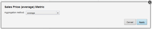

  2. To use the edit dialog to select the aggregation method:
    1. Click the edit icon for the metric.
    2. From the Aggregation method drop-down list, select the aggregation method.
      Metric configuration dialog displayed from the Chart edit view
    3. Click Apply.
