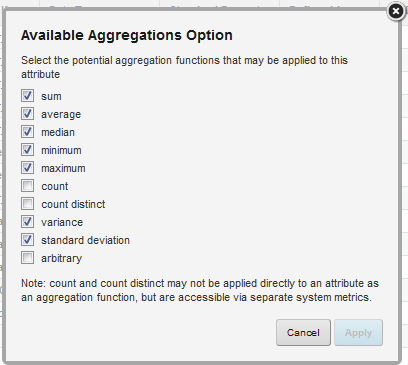

    1. In the Available Aggregations column, click the edit icon.
    2. On the Available Aggregations Option dialog, to enable an available aggregation method, check the checkbox.
      Available aggregations dialog
    3. To disable an aggregation method, uncheck the checkbox.
    4. To confirm the settings, click Apply.
