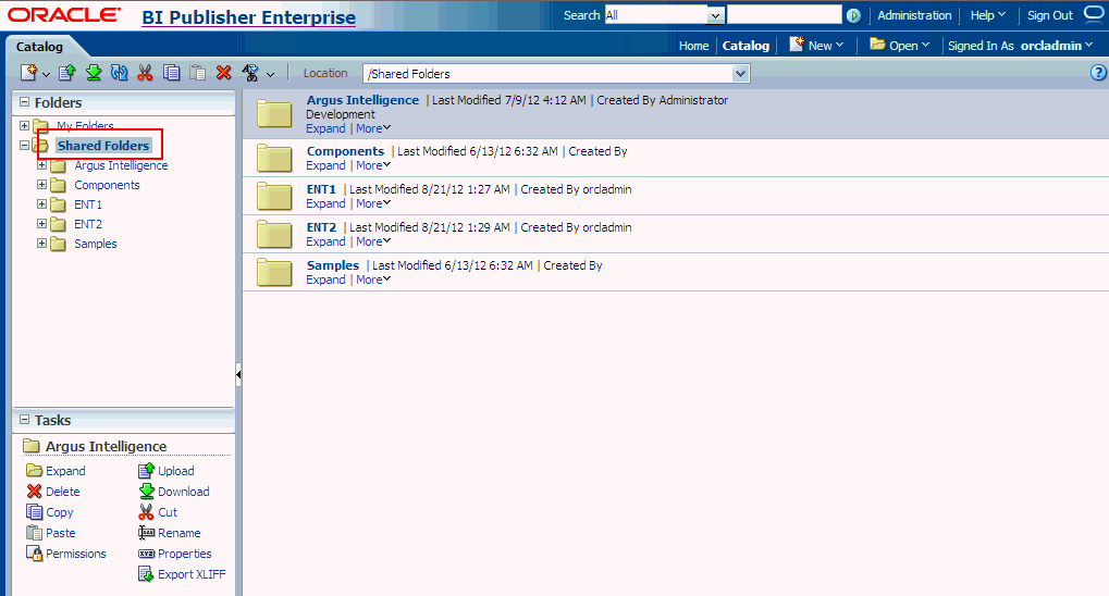

  4. Click Shared Folders in the Folders section as shown in the following figure:
    Surrounding text describes sharedfolders.gif.

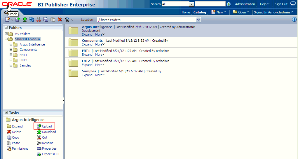

  5. Click Upload in the Tasks section as highlighted in the following figure:
    Surrounding text describes uploadfile.gif.

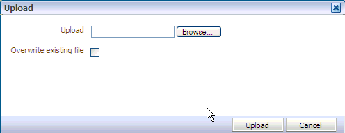

    This displays the Upload dialog box as shown in the following figure:
    Surrounding text describes uploadscreen.gif.
  6. Click Browse and navigate to the location where you have saved the Argus Insight.xdrz file on the local file system.

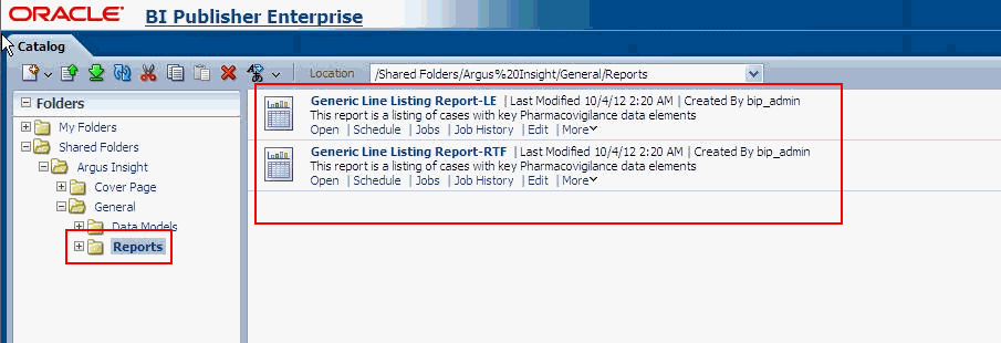

  7. Click Upload. Once done, an Argus Insight folder is created in Shared Folders.
  8. Expand the Argus Insight folder to verify that the Generic Line Listing Data Model exists in the Data Models sub-folder and the Generic Line Listing Report in LE and RTF formats exists in the Reports sub-folder as highlighted in the following figure:
    Surrounding text describes linelistingreports.gif.

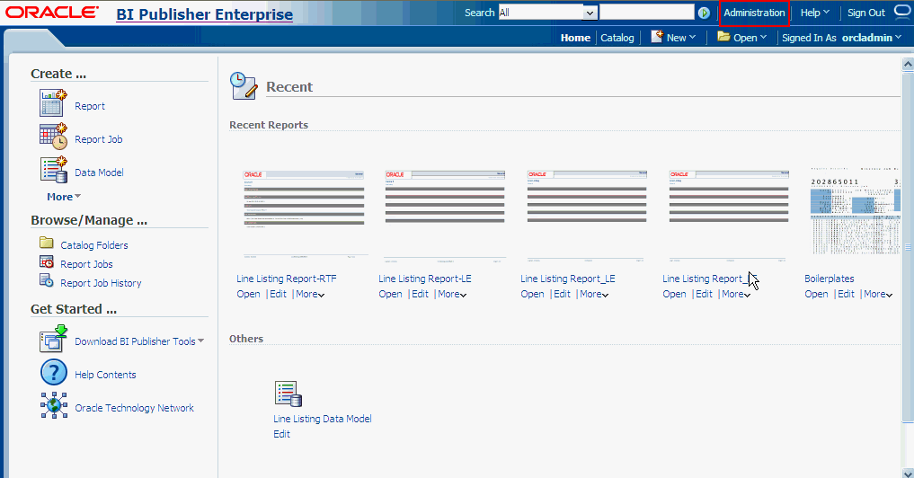

  1. Log on to BIP using the administrator credentials. This displays the BIP Home Page as depicted in the following figure:
    Surrounding text describes biphome.gif.

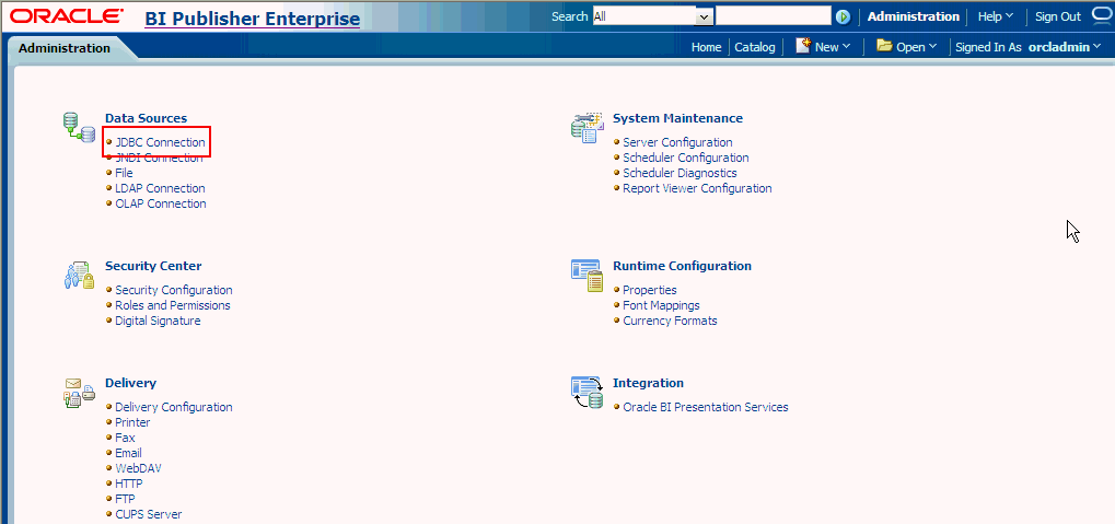

  2. Click Administration as highlighted in the following figure:
    Surrounding text describes administration.gif.
  3. Click JDBC Connection in the Data Sources section as shown in the following figure:
    Surrounding text describes jdbcconnection.gif.

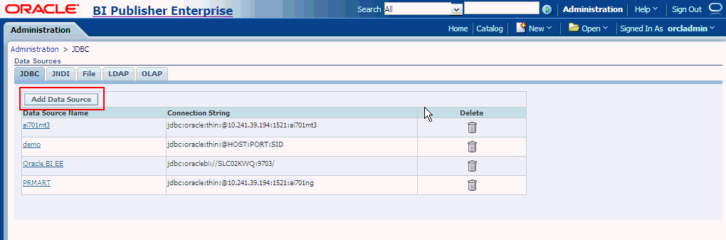

    This displays the Data Sources Screen.
  4. Click Add Data Source as highlighted in the following figure:
    Surrounding text describes adddatasource.gif.

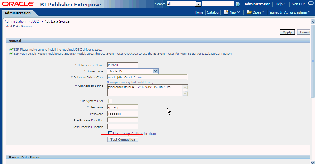

  5. In the Add Data Source section:
    1. Enter PRMART in the Data Source Name field.
    2. Select the database from the Driver Type drop-down list. This auto-populates the Database Driver Class field.
    3. Enter the connection string in the Connection String field. You must enter all the details in lower case in this field.
    4. Enter the username (Argus Insight application DB user, for example, apr_app) to connect to the database in the Username field.
    5. Enter the password for the user in the Password field.

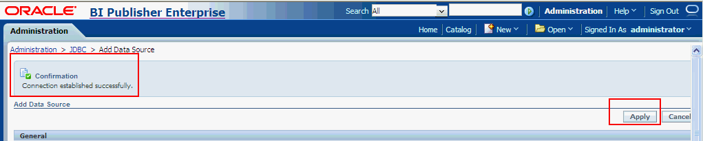

    6. Click Test Connection as shown in the following figure:
      Surrounding text describes testconnection.gif.
      If successful, this displays a confirmation message, as shown in the following figure:
      Surrounding text describes applychanges.gif.

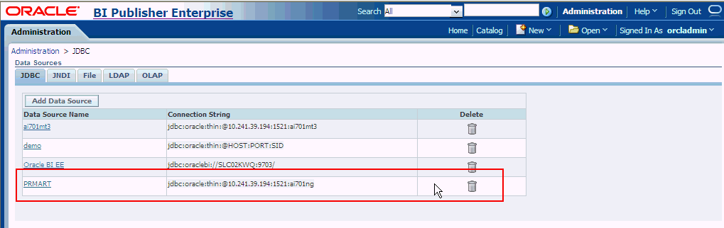

  6. Click Apply. This displays the PRMART Data Source in the list of already existing data source names as shown in the following figure:
    Surrounding text describes datasourcenames.gif.
    This successfully creates a connection between BIP and the database.

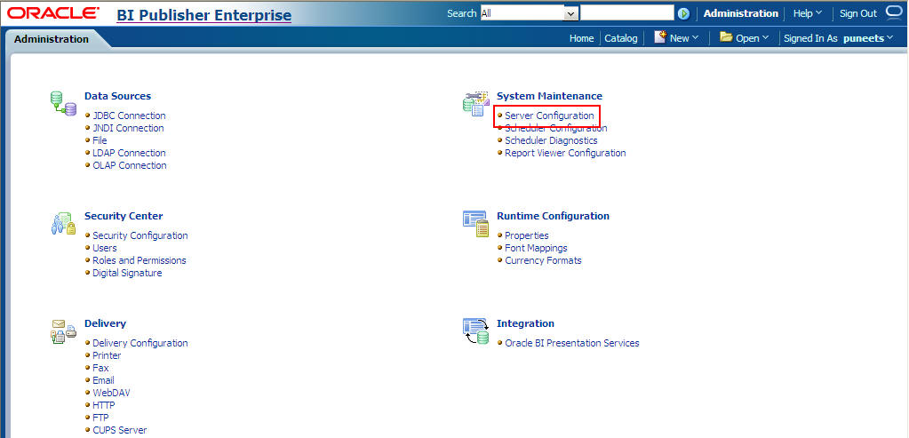

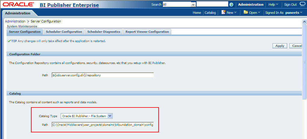

  3. Click Server Configuration in the System Maintenance section as highlighted in the following figure:
    Surrounding text describes userroles29.jpg.
    This displays the Server Configuration Screen.
  4. In the Catalog section, select Oracle BI Publisher - File System from the Catalog Type drop-down list. If the Catalog Type is not Oracle BI Publisher - File System, the folder level permission settings cannot be done in BIP. Refer to the BIP Technical Reference document for more information.
    Only Oracle BI Publisher - File System is supported in this release.
  5. Enter the path where all BIP folders, data models, and BIP reports will be stored in the BIP server as highlighted in the following figure:
    Surrounding text describes userroles30.jpg.
  6. Click Apply to save the changes.
  7. Restart the BI server.

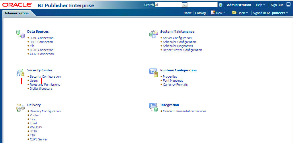

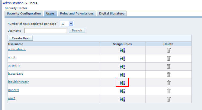

  3. Click Users in the Security Center section as highlighted in the following figure:
    Surrounding text describes userroles24.jpg.
    This displays the Users screen.

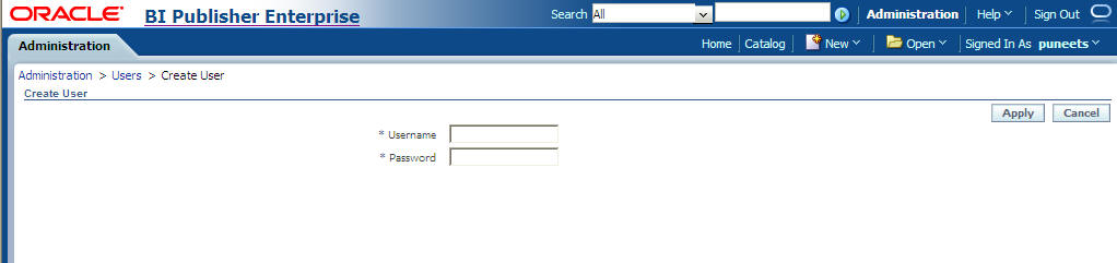

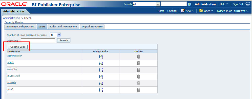

  4. Click Create User as highlighted in the following figure:
    Surrounding text describes userroles25.jpg.
    This displays the Create User Screen as shown in the following figure:
    Surrounding text describes userroles26.jpg.
  5. Enter the name of the user in the Username field.
  6. Enter the password in the Password field.
  7. Click Apply. The name of the user is displayed in the list of existing users.
    Once you have created the user, you need to assign the required roles to the user.

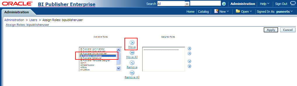

  8. Click the Assign Roles icon corresponding to the user that you have created as highlighted in the following figure:
    Surrounding text describes userroles27.jpg.
    This displays the Assign Roles Screen for the user. The BIP system roles such as BI Publisher Administrator, BI Publisher Excel Analyzer, BI Publisher Online Analyzer, BI Publisher Developer, BI Publisher Scheduler, and BI Publisher Template Designer are available by default along with the custom roles (if any) that have been created by you. See section Creating Roles, Adding Data Sources, and Assigning Roles for the steps to create custom roles. For more information on system roles, refer to Understanding BI Publisher's Users, Roles, and Permissions in Administrator's Guide for Oracle Business Intelligence Publisher.
  9. Select the role that you want to assign to the user from the Available Roles section and click Move(>) to move the selected role to the Assigned Roles section as depicted in the following figure:
    Surrounding text describes userroles28.jpg.
  10. Click Apply. This assigns the selected roles to the user.

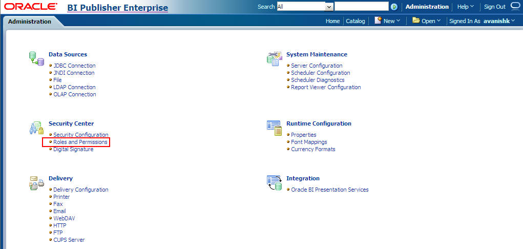

  3. Click Roles and Permissions in the Security Center section as highlighted in the following figure:
    Surrounding text describes userroles46.jpg.
    This displays the Roles and Permissions Screen.

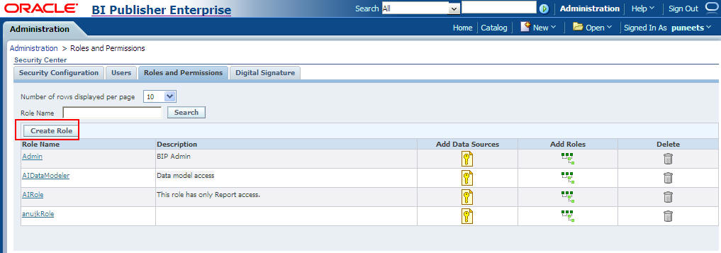

  4. Click Create Role as shown in the following figure:
    Surrounding text describes userroles32.jpg.
    This displays the Create Role Screen.

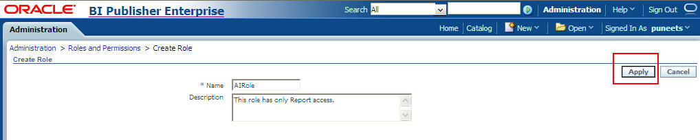

  5. Enter the name of the role in the Name field.
  6. Enter the description for the role in the Description field.
  7. Click Apply to create the new role, as highlighted in the following figure:
    Surrounding text describes userroles33.jpg.
    This displays the role in the list of existing roles on the Roles and Permissions Screen.

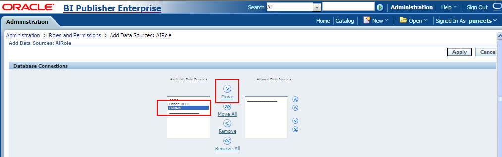

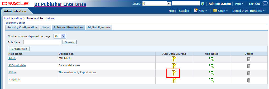

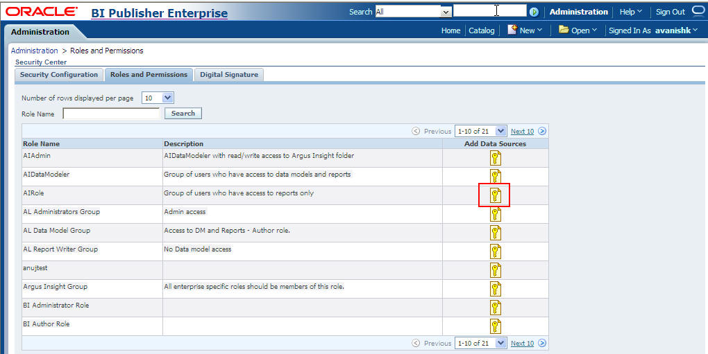

  8. Click Add Data Sources Icon, corresponding to the role which you have just created, as depicted in the following figure:
    Surrounding text describes userroles34.jpg.

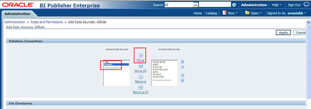

    This displays the Add Data Sources Screen.
  9. Select PRMART from the Available Data Sources section and click Move(>) to move it to the Allowed Data Sources section, as highlighted in the following figure:
    Surrounding text describes userroles35.jpg.
  10. Click Apply to save the changes. This again displays the Roles and Permissions Screen. See Creating PRMART JDBC Connection section for the steps to create the JDBC connection.

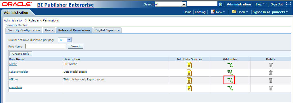

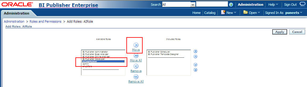

  11. Click the Add Roles icon, corresponding to the role which you have just created to add the required roles, as shown in the following figure:
    Surrounding text describes userroles36.jpg.
    This displays the Add Roles Screen.
  12. Select the roles that you want to include for the role from the Available Roles section and click Move(>) to move the selected roles to the Included Roles section, as highlighted in the following figure:
    Surrounding text describes userroles37.jpg.
  13. Click Apply to save the changes.

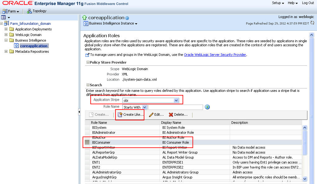

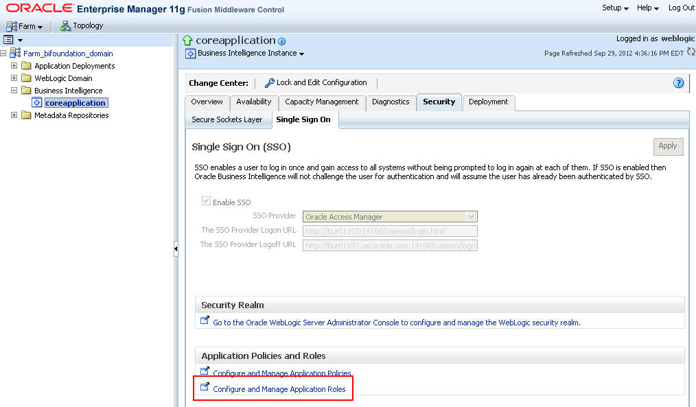

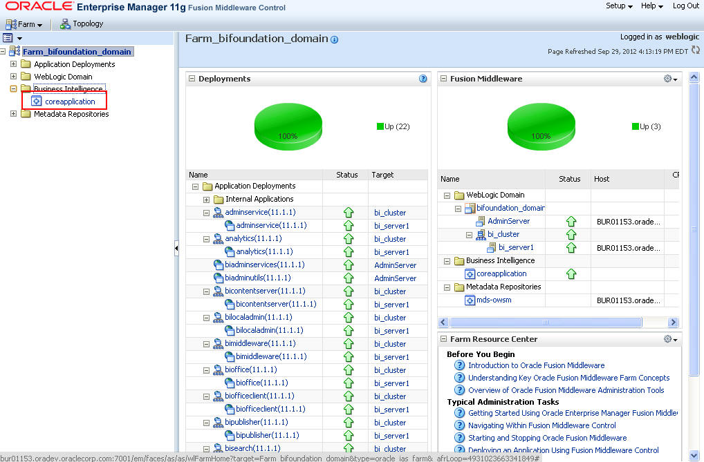

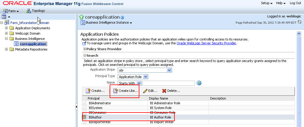

  1. Log on to the Enterprise Manager. This displays the Enterprise Manager home page with a list of folders in the left pane.
  2. Expand the Business Intelligence folder in the left pane and click coreapplication, as shown in the following figure:
    Surrounding text describes userroles38.jpg.
    This displays the coreapplication Screen in the right pane.

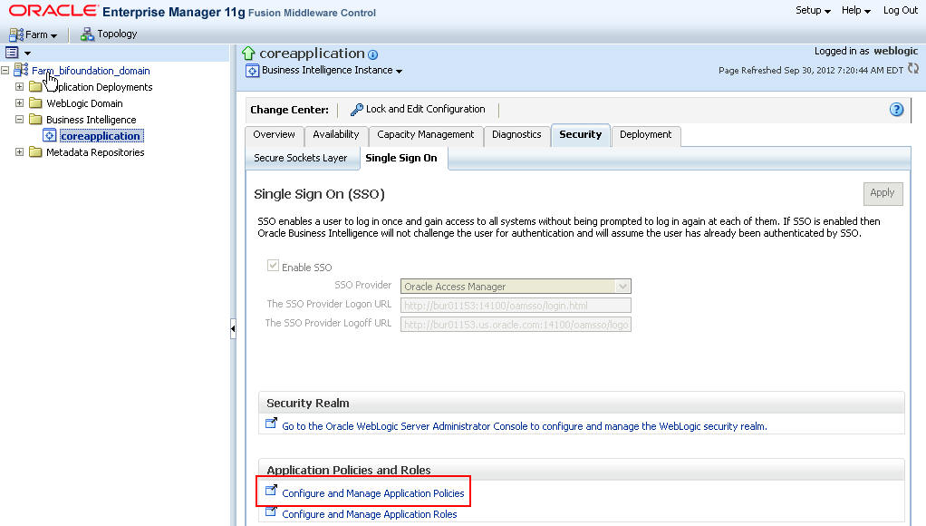

  3. Click Configure and Manage Application Roles in the Application Policies and Roles section, as shown in the following figure:
    Surrounding text describes userroles39.jpg.
    This displays the Application Roles Screen.

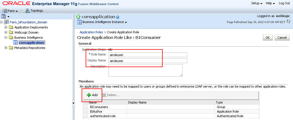

  4. Select the required application stripe from the Application Stripe drop-down list.
  5. Select any existing role (for example, BIConsumer) and click Create Like, as shown in the following figure:
    Surrounding text describes userroles40.jpg.
    This displays the Create Application Role Screen.
  6. Enter the name of the role in the Role Name field.
  7. Enter the display name and description for the role in the Display Name and Description fields. These are optional fields.

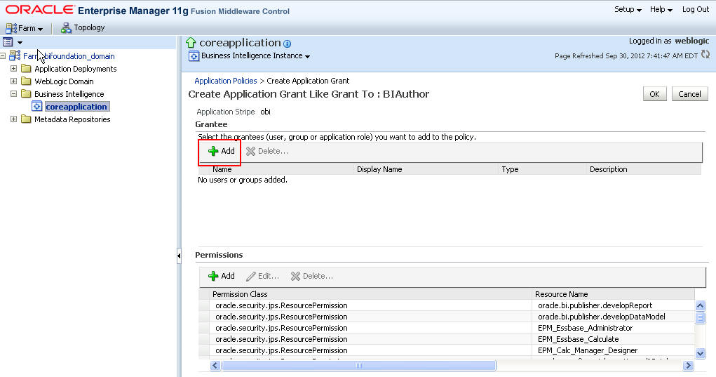

  8. Click Add to add any existing application role/group/user to the new role as shown in the following figure:
    Surrounding text describes userroles41.jpg.

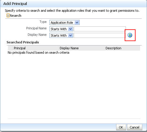

    This displays the Add Principal Screen.
  9. Click the > icon close to the Display Name field to display the list of all the roles, groups, and users that are created in LDAP server, as highlighted in the following figure:
    Surrounding text describes userroles42.jpg.
  10. Select the name of the role, group, or user that you want to add to the new role and click OK. For example, for the BIReportWriter role, BIConsumer and authenticated-role are mandatory members. Besides that, the AIRole must also be a part of the BIReportWriter Role. These roles are displayed in the Members section of the Create Application Screen, as shown in the following figure:
    Surrounding text describes bireport.jpg.
    The BIReportWriter role must be added to the BIReportWriter application policy. You can refer to the Creating Application Policy section for the steps to create the application policy for the BIReportWriter role.
  11. Repeat steps 8 to 10 to add more roles, users, and groups to the new role.
  12. Click OK on the Create Application Role Screen to save the changes.
    Once you have created the role and added the required list of users, roles, and groups to the new role. You must add the PRMART data source to the new role.
  13. Log on to BIP using the administrator credentials. This displays the BIP Home Page.
  14. Click Administration as highlighted in the following figure:
  15. Click Roles and Permissions in the Security Center section as highlighted in the following figure:
    Surrounding text describes userroles51.jpg.
    This displays the Roles and Permissions Screen. You can view the name of the new role which you have just created in the list of role names.
  16. Click the Add Data Sources icon corresponding to the name of the new role, as depicted in the following figure:
    Surrounding text describes userroles44.jpg.
  17. Select PRMART from the Available Data Sources section and click the Move (>) icon to move the PRMART data source to the Allowed Data Sources section as shown in the following figure:
    Surrounding text describes userroles45.jpg.
  18. Click Apply to save the changes.
  3. Click Configure and Manage Application Policies in the Application Policies and Roles section, as shown in the following figure:
    Surrounding text describes userroles47.jpg.
    This displays the Application Policies Screen.
  4. Select obi from the Application Stripe drop-down list.
  5. Select the BIAuthor policy and click Create Like as shown in the following figure:
    Surrounding text describes userroles48.jpg.
    This displays the Create Application Grant Like Screen with the Grantee and Permissions sections.
  6. Click Add in the Grantee section, as highlighted in the following figure:
    Surrounding text describes userroles49.jpg.
  7. Click the > icon close to the Principal Name field to retrieve the list of all the available application roles, as shown in the following figure:
    Surrounding text describes userroles50.jpg.
  8. Select the name of the role from the Searched Principals section (for example, BIReportWriter) and click OK. This again displays the Create Application Grant Like Screen.
  9. Select the developDataModel Resource Name from the list of Permission Classes and click Delete.
  10. Click OK to apply the changes.
