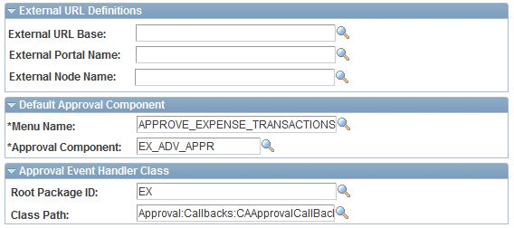

Image: Register Transactions page (3 of 3)
This example illustrates the fields and controls on the Register Transactions page (3 of 3). You can find definitions for the fields and controls later on this page.

External URL Definition
Use this section to define the external URL to identify the URL base, portal and node. External URL is used to notify any step that has a been set to External.
Default Approval Component
Identifies the default component that users should go to when selecting a worklist entry.
| Menu Name |
Select the menu name that contains the component you want to register for the Worklist. |
| Approval Component |
Select the component on which the approval is going to be based. |
Approval Event Handler Class
Use this section to define the application class used to monitor events for this transaction. Each time an event occurs, the Approval Framework notifies the application. For applications to receive the notifications, application developers must extend the event handler class, ApprovalEventHandler.
When a transaction results in an action from the Approval Framework, the event handler class you specify how to proceed with the transaction.
The event handler base class defines the handler methods that you can override by extending classes. The extending class must have a no-argument constructor, since the system instantiates the class with no arguments.
