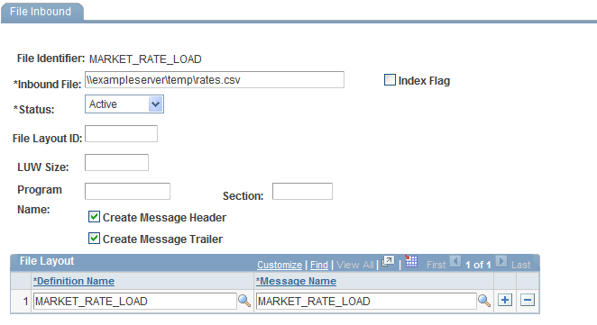

File Inbound Page
Use the File Inbound page (EO_FILE_INBOUND) to set up inbound flat file processing.
Image: File Inbound page
This example illustrates the fields and controls on the File Inbound page. You can find definitions for the fields and controls later on this page.
Referencing Application Engine Program
The file inbound setup allows you to reference an AE program and section that gets called as soon as the data processing of the specified inbound file is completed. This functionality comes in handy if you wish to invoke customized actions after the flat file utility finishes processing data--simply build the custom AE program and specify it on this page for the corresponding file rule.

File Layout
Note: Use the wildcards * and ? for the file name but not for the directory path. The file layout and message mapping must be valid for all files that meet the wildcard criteria.

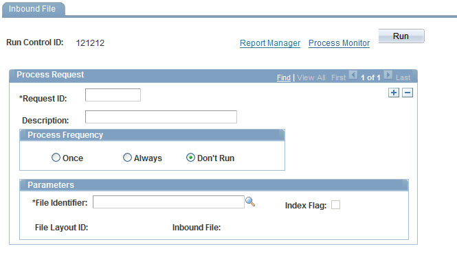

Inbound File Page
Use the Inbound File page (EO_FILETOMSG) to initiate inbound flat file processing.
This file-to-message processing function reads the file rowset and publishes it as a message.
Image: Inbound File page
This example illustrates the fields and controls on the Inbound File page. You can find definitions for the fields and controls later on this page.
Use this page to initiate inbound flat file processing. This file-to-message processing function reads the file rowset and publishes it as a message.
Parameters
| File Identifier |
Select or enter the name of the file identifier that you set up in the File Inbound page. The file identifier is tied to the publish rules. |
| Run |
Click to run this request. |
