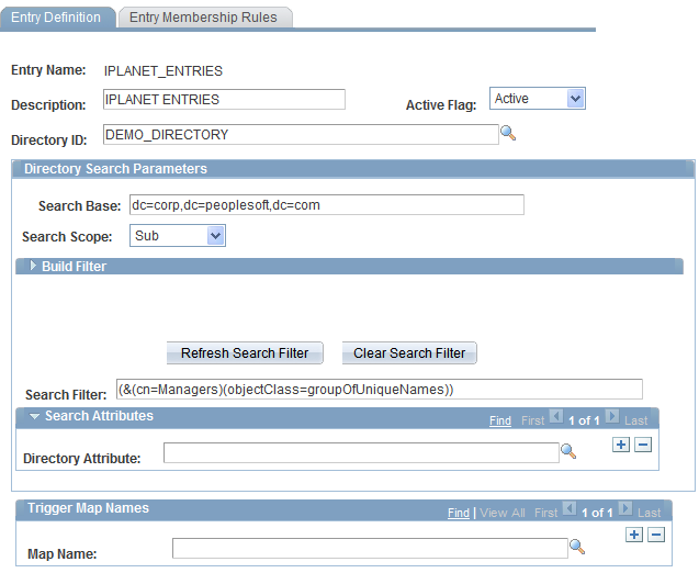

Entry Definition Page
Use the Entry Definition page (EO_DSCONTAINERDEFN) to create a directory entry definition.
Image: Entry Definition page
This example illustrates the fields and controls on the Entry Definition page. You can find definitions for the fields and controls later on this page.
Use this page to create a directory entry definition.
Directory Search Parameters
Build Filter
Search Attributes
Trigger Message Names
Note: Run the directory audit if an entry rule has changed or if you want to initialize the directory entries.

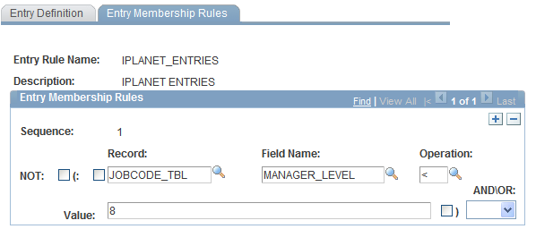

Entry Membership Rules Page
Use the Entry Membership Rules page (EO_DSSECRULES) to establish entry membership rules.
Image: Entry Membership Rules page
This example illustrates the fields and controls on the Entry Membership Rules page. You can find definitions for the fields and controls later on this page.
Use this page to establish entry membership rules.
The entry rules are logical expressions that can be either true or false. They are composed of filters on database objects associated by logical operators. Rules have the following form:
[NOT] [ ( ] Record . Field operatorConstant [ ) ] [AND/OR]
The symbols between square brackets are optional. The operator can be <, <=, <>, =, >, or >=. A rule set is composed of single rules joined by AND or OR Boolean operators if necessary. The following example shows a series of single rules joined to make one compound rule.
( JOB.LOCATION = ‘KC004’ AND [1] JOB.COMPRATE > 15000 ) OR [2] NOT JOB.DEPTID = ‘GBIY004’[3]
Note: No limits are imposed on the number of rules used within a rule set.
