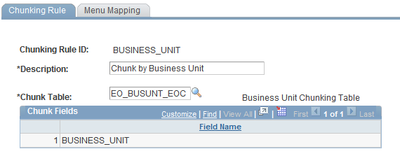

Chunking Rule Page
Use the Chunking Rule page (EO_CHUNKRULE) to define the chunking rule description.
Image: Chunking Rule page
This example illustrates the fields and controls on the Chunking Rule page. You can find definitions for the fields and controls later on this page.
Chunking Rule page
In message chunking, all data within the message contains the same break field. For example, if the break field is business unit, all transactions in the message are for the same business unit.
To ensure that the message publishes when you use chunking rules:
  1. Add subscribing nodes to the chunking node table.
  2. In PeopleSoft Application Designer, add OnRouteSend PeopleCode to return a list of subscribing nodes.

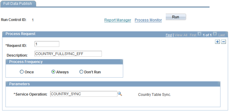

Full Data Publish Page
Use the Full Data Publish page (EO_FULLDATAPUB) to create the run control for the Full Data Publish utility.
The run control associates publish rule definitions with the scheduled Full Publish process run. For example, you can set up a run control to publish both customer and sales order full messages at the end of each day.
Image: Full Data Publish page
This example illustrates the fields and controls on the Full Data Publish page. You can find definitions for the fields and controls later on this page.
Use this page to create the run control for the Full Data Publish utility.
The PeopleSoft system adds a run control for the currently effective FullSync message that is chunked by the setID CUSTOMER_FULLSYNC_EFF_SETID.
Note: If you insert a new row, the same run control component can publish more than one message, so you can produce both the full message and the current effective-dated full message from the same PeopleSoft Process Scheduler run.
Note: You must set up the run control parameters to start the Full Data Publish program.

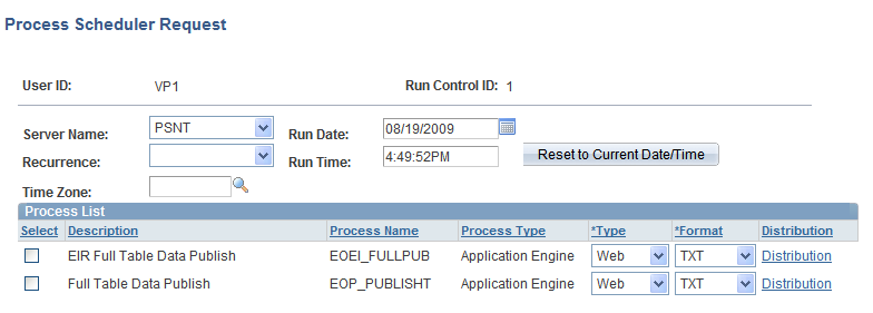

Performing Full Table Replication
Access the Full Data Publish page (select Enterprise Components, then select Integration Definitions, then select Initiate Processes, then select Full Data Publish).
Click the Run button on the Full Data Publish (EO_FULLDATAPUB) page to access and select the Full Table Data Publish check box and perform a full table replication.
Image: Process Scheduler Request page showing the Full Table Data Publish option
This example illustrates the fields and controls on the Process Scheduler Request page showing the Full Table Data Publish option. You can find definitions for the fields and controls later on this page.
