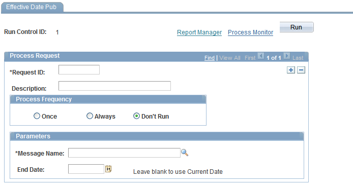

Effective Date Pub Page
Use the Effective Date Pub page (EO_EFFDATAPUB) to run the Effective Date Publish utility.
Image: Effective Date Pub page
This example illustrates the fields and controls on the Effective Date Pub page. You can find definitions for the fields and controls later on this page.
