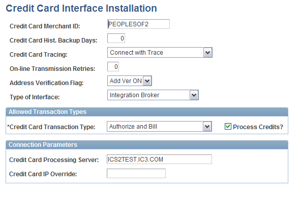

Credit Card Interface Installation Page
Use the Credit Card Interface Installation page (EOEC_CCI_INSTAL) to define connection parameters for credit card processing calls to a third-party vendor.
Before you set up credit card processing options, establish your merchant account with a third-party vendor.
Note: Before you set up credit card processing options, establish your merchant account with a third-party vendor.
Note: Check the installation documentation for the product you are installing for specific details on setting up credit card interfaces.
Image: Credit Card Interface Installation page
This example illustrates the fields and controls on the Credit Card Interface Installation page. You can find definitions for the fields and controls later on this page.
Verify connection requirements with your vendor.
Allowed Transaction Types
Connection Parameters
The third-party vendor that you integrate with will provide you with information to connect with their systems. Enter that information to enable your PeopleSoft system to make the connection when you submit a transaction for processing.

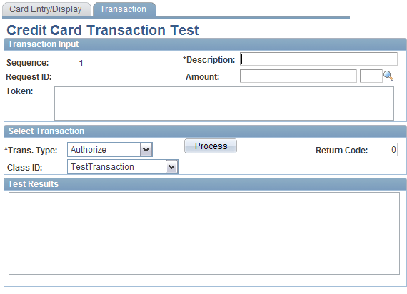

Credit Card Transaction Test Page
Use the Test Credit Card Interface - Transaction page (EOEC_CCI_TRANSACT) to enter test credit card transaction information that you can submit to verify that your credit card processing is functioning properly.
Image: Test Credit Card Interface - Transaction page
This example illustrates the fields and controls on the Test Credit Card Interface - Transaction page. You can find definitions for the fields and controls later on this page.
Use this page to enter test credit card transaction information that you can submit to verify that your credit card processing is functioning properly.
The test that you can run on this page verifies that your environment is set up correctly to process online credit card transactions using XML Compliant integration.
Note: This does not test the environment that is set up for batch credit card transactions.
Return Codes
You can enter any of the following return codes and click Process to view the corresponding description and error message in the Test Results area. These return codes and their corresponding error messages can appear in multiple areas. For example, when you are using the Test Credit Card Interface component, they appear on this test page. In an application, they appear as appropriate for that application's method of interacting with the credit card interface.
