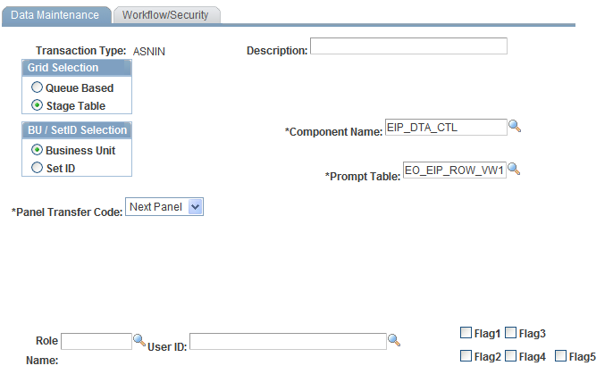

Data Maintenance Page
Use the Data Maintenance page (EO_EIP_CTL_SETUP1) to set up the Error Handling utility and correct message errors.
Image: Data Maintenance page
This example illustrates the fields and controls on the Data Maintenance page. You can find definitions for the fields and controls later on this page.
Use this page to set up the Error Handling utility and correct message errors.

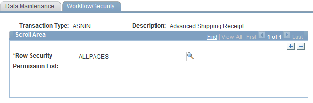

Workflow/Security Page
Use the Workflow/Security page (EO_EIP_CTL_SETUP2) to set up row security.
Image: Workflow/Security page
This example illustrates the fields and controls on the Workflow/Security page. You can find definitions for the fields and controls later on this page.
Use this page to set up row security.

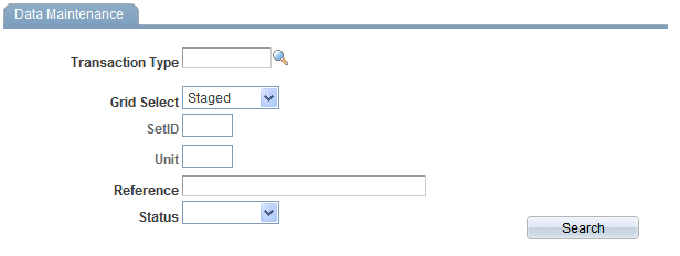

Use the Data Maintenance page (EO_EIP_CTL_MAINT) to test the error handling utility.
Test subscription processes must error out. Create a message subcontract with Error status, or create a stage-based incoming transaction with a status value of 1 (Error).
