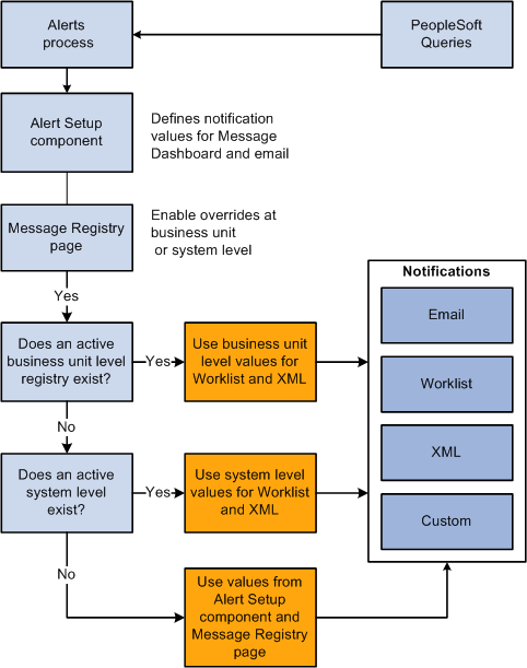

The Process Flow of Alert Messages Generated by a PeopleSoft Query
Image: Generating Alert messages from a PeopleSoft Query
This diagram illustrates the process flow of notifications produced by a PeopleSoft Query in combination with the Alert feature. The Alert process is run for one or more PeopleSoft Queries. If issues are found, then message object data is generated using the values included in the Alert Setup component, the BU-Level Notifications page, or the System-Level Notifications page. The appropriate person is notified using the Notification Dashboard page, an email, a worklist entry, or an XML message.
One or more PeopleSoft Queries are run using the Alerts process page.
Values are collected from the Alert Setup component, the BU-Level Notifications page, or the System-Level Notifications page based on process name, process category, and query name. These values include:
Where to log the message (any combination of the Notification Dashboard, PeopleSoft Worklist, email, and XML notification).
The message set and message number.
User roles, user IDs, email addresses, or PeopleSoft nodes needed to route the message to the correct location.
Links to the PeopleSoft page where the transaction can be viewed or corrected.
You must use the Notification Registry page to enable the overrides for the process name and process category.
The Alert Setup component defines values for the Notification Dashboard and email notifications. The BU-Level Notifications page or the System-Level Notifications page define values for the PeopleSoft Worklist and XML notifications. If there are no entries on the BU-Level Notifications page for the process name and the process category, then the PeopleSoft system checks to see if the values have been defined at the system level using the System-Level Notifications page.
The message is posted to the Notification Dashboard and other locations based on the values used. If the notification is sent using an email or a worklist entry, a link is provided to take the individual to the message detail page of the Notification Dashboard.
