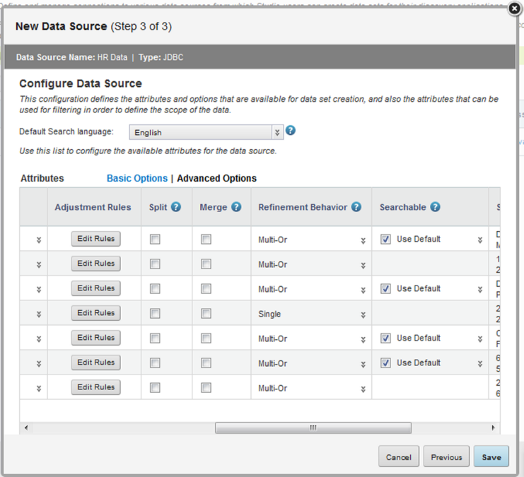

On the Configure Data Source page of the data source configuration dialog, you configure the attributes that are included in the data source.
The configuration for data source attributes includes most of the options available when users create new data sets. This allows you to provide default values that should in most cases be correct, so that users do not have to change them.
When the page is first displayed, it shows the Basic Options view.
To display additional configuration options for the attributes, click Advanced Options.

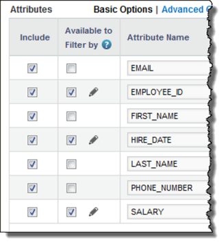

If the checkbox is checked, then the column is included in the data source.
By default, the checkbox is checked for all columns for which the Provisioning Service can retrieve data.
If the data is not accessible, for example because the column is a constant or a reference to another column, then the checkbox is unchecked by default. If a checkbox is unchecked by default, it is recommended that you leave it unchecked.
If you do not specifically enable any of the attributes for filtering, then users cannot filter the data at all. If the source data contains a very large number of records, then it is recommended that you enable filtering for some of the attributes.
Note that only numeric, string, and date/time fields can be enabled for filtering. Users can never use time or duration fields for filtering.
You also should be careful about allowing users to filter by database columns that use CHAR or NCHAR as the original column type. If the columns contain values that are padded with spaces, users may have difficulty getting values to match when they go to filter the data. For example, if the value is actually "abc" followed by two spaces, there won't be a match when users type "abc" without the spaces.
When you check the checkbox, an edit icon is added to the column.

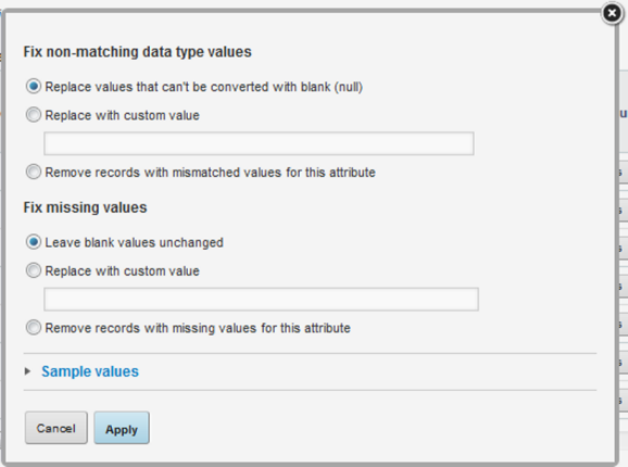

Note that if an attribute is not initially identified as a date, you cannot change the data type to make it a date.
Note that because string values never have non-matching values, you cannot configure rules for adjusting invalid values.

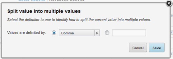

The Split option is used when the attribute value is actually a list of values. For example, for a Color attribute, you can indicate that "blue;red;white" are actually three separate values delimited by a semicolon.
To split the value for an attribute:
Select the delimiter from the drop-down list. If the delimiter used is not in the drop-down list, click the other radio button, then type the delimiter in the field.

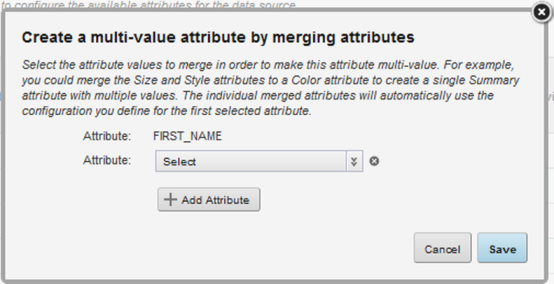

The Merge option is used to combine values from other attributes into the current attributes. For example, you could add the values from Color2 and Color3 to the Color1 attribute in order to generate the full list of colors.
To merge values from multiple attributes:
The merged attributes must be of the same type as the original attribute.
On the Configure Data Source page, you can no longer edit the merged attributes. They automatically inherit all of the configuration options you specify for the original attribute.
The Merge checkbox is also checked for those attributes.
The refinement behavior indicates whether users can refine by multiple values, and whether multiple values use AND or OR.
The available options are:
| Option | Description |
| Multi-Or | Indicates that end users can refine by
more than one value at a time.
For multi-or, a record matches if it has at least one of the selected values. So if an end user selects the values Red, Green, and Blue, then matching records only need to have one of those values (Red or Green or Blue). For most attributes, this is the default and the recommended value. Date attributes are always multi-or. |
| Multi-And | Indicates that end users can refine by
For multi-and, a record matches only if it has all of the selected attribute values. Multi-and should only be used with multi-value attributes. So if an end user selects the values Red, Green, and Blue, then matching records must have all of those values (Red and Green and Blue). |
| Single | Indicates that end users can only
refine by one value at a time.
The Single refinement behavior is recommended for string attributes with long values, and numeric and geocode attributes with a large number of unique values. It is not recommended for multi-value attributes, including attributes that you have split or merged. |
Text searches are when end users use the Search Box component to search for a specific search term.
The Searchable checkbox is only displayed and checked by default for all string attributes.
Other types of attributes do not support text search.
To exclude the attribute from text searches, uncheck the Searchable checkbox.
By default, the text search for the attribute uses the default search language. If the attribute values are in a different language than the default, then use the drop-down list to select the search language.
