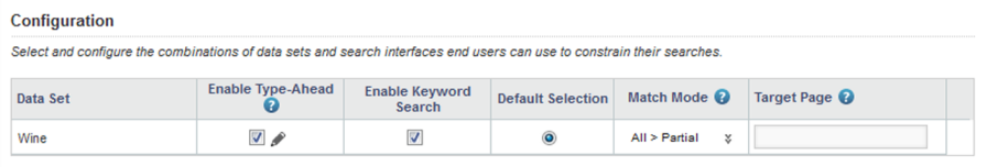

From the edit view of the Search Box component, you configure the available search options.

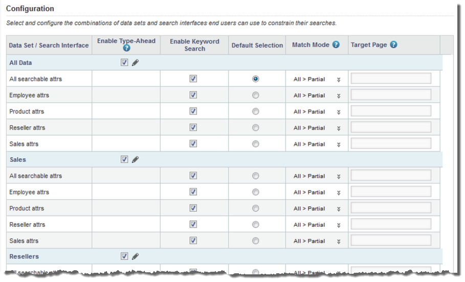

The Configuration tab of the edit view displays the list of application data sets, plus an entry for All Data. For each data set, you can enable and disable type-ahead searches. Below each data set, as well as below All Data, are listed the search interfaces associated with the application.
If there is only one data set, and one search interface, then the list contains a single row.
For each combination of data set and search interface, you can configure additional details for keyword searches, as well as the target page to display when users complete a search.
