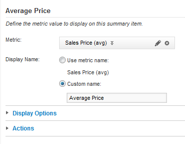

For a metric summary value, on the Define Item tab of the Summarization Bar edit view, you select the metric value to display.
Metric selection for a metric summary item
To select and configure the summary item value for a metric summary item:
  1. To select the metric:
    1. Click the Select Metric button.
      Select Metric button for a metric summary item
    2. On the Select a Metric dialog, click the metric you want to use. You can use the filter field to search for a specific metric.
    3. Click Apply.
  2. To select a different aggregation method for a metric, you can use the drop-down list next to the metric name.
    You cannot select a different aggregation method for a predefined metric.
  3. To select a different metric:
    1. Click the delete icon for the current metric.
    2. Click the Select Metric button.
    3. On the Select a Metric dialog, click the metric you want to use.
    4. Click Apply.
  4. To configure the metric:
    1. Click its edit icon.
    2. For metrics that are not predefined, the configuration dialog includes a drop-down list to select the aggregation method.
    3. The Value Formatting section allows you to customize the format of the displayed value.
      For details on customizing a displayed value on a component, see Configuring the format of values displayed on a component.
