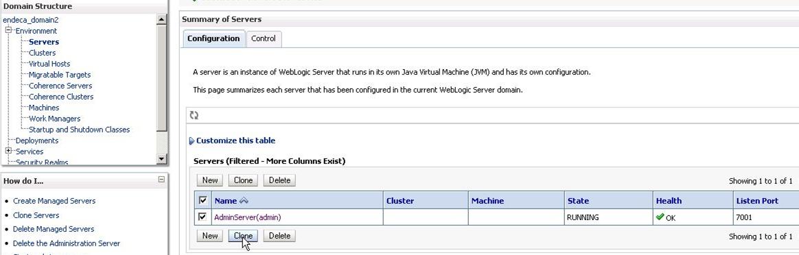

    3. Go to Environment > Servers and select the Admin Server.
      The Clone option is activated.

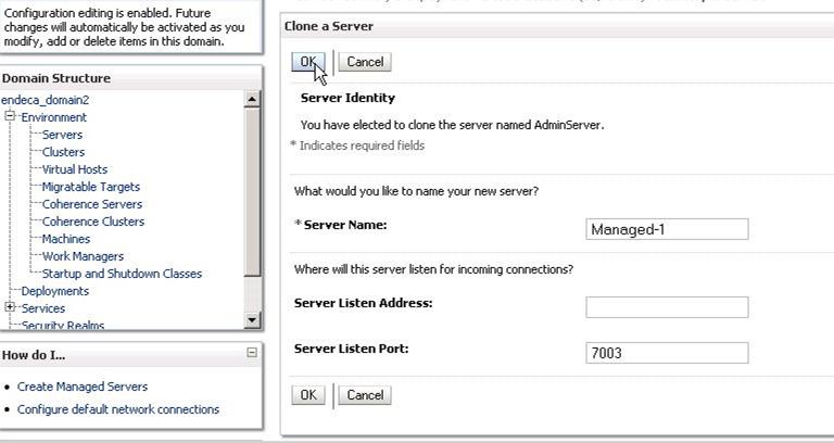

    4. Click Clone.
      The next window opens.
    5. Change the Server Name (this is the Managed Server name) to Managed-1.
    6. Change the Server Listen Port to be 7003, leave the other fields unchanged, and click OK.

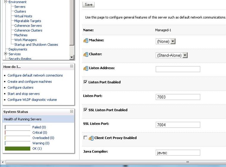

      The server named Managed-1 is created, but its SSL Listen Port must be enabled and specified.
    7. Click Managed-1 to edit it, and in the edit screen, check SSL Listen Port Enabled, change SSL Listen Port to 7004, leave other options unchanged, and click Save.

  4. In the edit screen for this server, verify that the SSL Listen Port for it is already enabled and listed as 7004.
