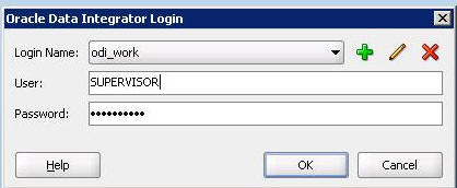

Open the Oracle Data Integrator Studio and click Connect to Repository. This displays the Oracle Data Integrator Login window, as depicted in the following figure:
In the Oracle Data Integrator Login window:
Select the ODI Work Repository name from the Login Name drop-down list.
Enter the name of the ODI user in the User field.
Enter the password for the ODI user in the Password field.
Click OK. This displays the Oracle Data Integrator Screen.

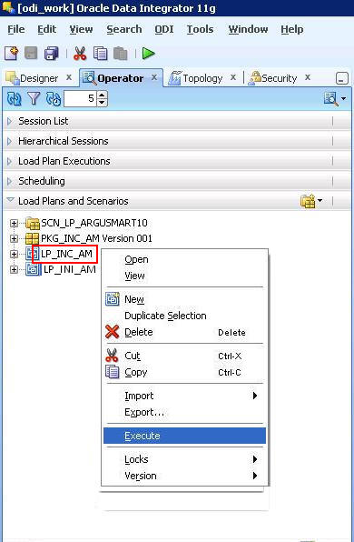

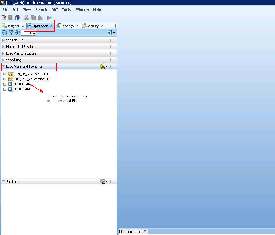

Select the Operator tab in the left pane.
Expand the Load Plans and Scenarios section, as highlighted in the following figure:
The LP_INC_AM option in this section represents the load plan for the Incremental ETL process for AM.
Right-click the LP_INC_AM option. This displays a menu, as shown in the following figure:

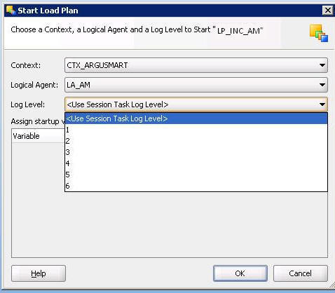

Click Execute. This displays the Start Load Plan window, as shown in the following figure:
In the Start Load Plan window:
Select CTX_ARGUSMART from the Context drop-down list.
Select LA_AM from the Logical Agent drop-down list.
Select the desired log level from the Log Level drop-down list.

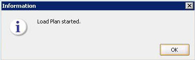

Click OK. This displays the Information dialog box with the Load Plan Started confirmation message, as shown in the following figure:
Click OK.

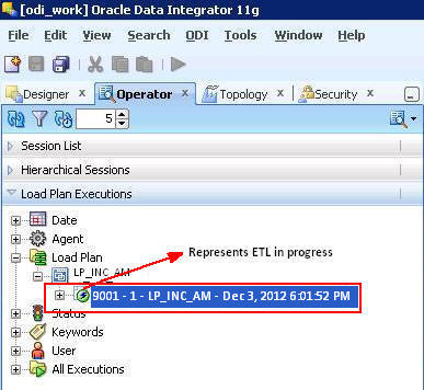

You can verify the status of the ETL process by navigating to the Load Plan Executions section and expanding the Load Plan folder. You can view the status of the Load Plan in Green color with tilted s, which signifies that the ETL session is in progress, as highlighted in the following figure:

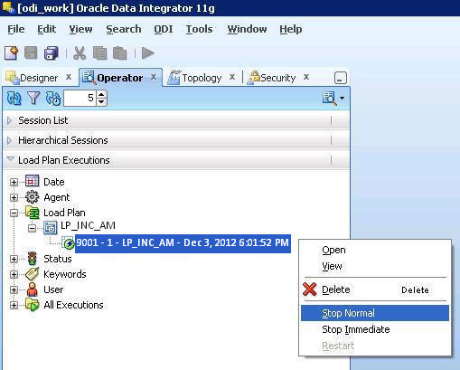

Right-click the Load Plan, which you want to stop, in the Load Plan folder of the Load Plan Executions section. This displays a menu, as shown in the following figure:

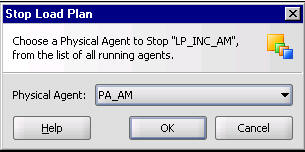

Select Stop Normal. This displays the Stop Load Plan dialog box, as depicted in the following figure:
Select PA_AM from the Physical Agent drop-down list.
Click OK. This stops the execution of the Load Plan.

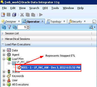

You can verify the status of the ETL process by navigating to the Load Plan Executions section and expanding the Load Plan folder. You can view the status of the Load Plan in Red color with the X symbol, which signifies that the ETL session is not in progress, as highlighted in the following figure:

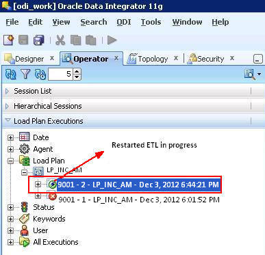

Restarting the Incremental ETL process enables you to start the ETL process from the last execution step where it was stopped or failed.
To restart the Incremental ETL, execute the following steps:

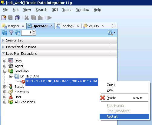

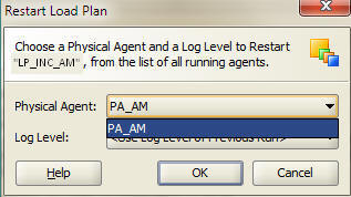

Right-click the Load Plan, which you want to restart, in the Load Plan folder of the Load Plan Executions section. This displays a menu, as shown in the following figure:
Click Restart. This displays the Restart Load Plan dialog box, as shown in the following figure:
Select the required log level from the Log Level drop-down list.

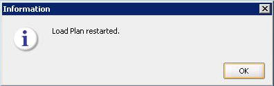

Click OK. This displays the Information dialog box with the Load Plan restarted message, as depicted in the following figure:
Click OK.

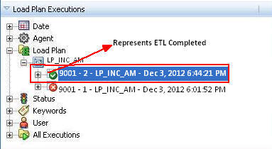

This adds another Load Plan, with the same name as that of the stopped ETL, in the Load Plan folder of the Load Plan Executions section. However, this instance of the ETL Process is in Green color with a tilted S, which signifies that the ETL is in progress, as highlighted in the following figure:
Once the ETL process is complete, the Load Plan is displayed in Green color with a completed symbol, as highlighted in the following figure:

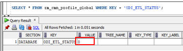

SELECT * FROM rm_cmn_profile_global WHERE KEY = 'ODI_ETL_STATUS';
The entry for the Value column must be 0 after executing this statement, as depicted in the following figure:

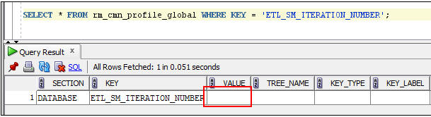

SELECT * FROM rm_cmn_profile_global WHERE KEY = 'ETL_SM_ITERATION_NUMBER';
The entry for the Value column must be blank after executing this statement, as depicted in the following figure:

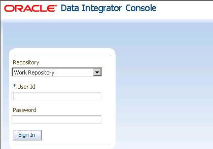

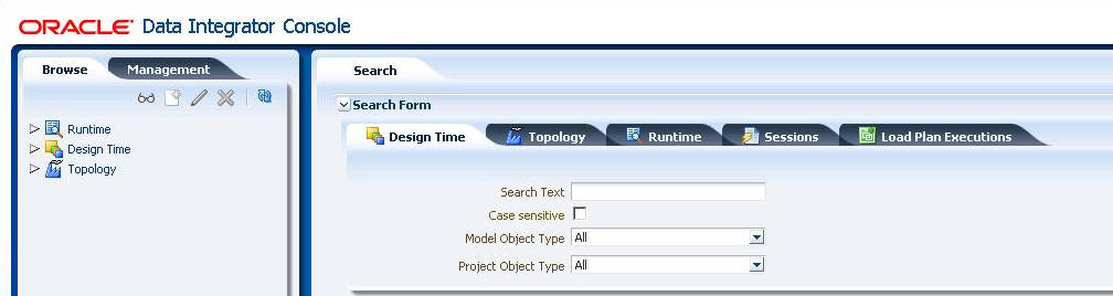

Open the Oracle Data Integrator Console. This displays the Oracle Data Integrator Console Sign In window, as depicted in the following figure:
In the Oracle Data Integrator Sign In window:
Select the ODI Work Repository name from the Repository drop-down list.
Enter the name of the ODI user in the User Id field.
Click Sign In. This displays the Oracle Data Integrator Console Screen, as shown in the following figure:

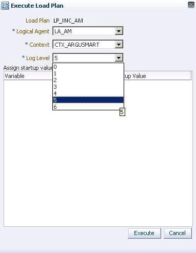

This displays the Execute Load Plan window, as shown in the following figure:
In the Execute Load Plan window:

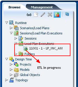

Click Execute. This displays the Information dialog box with the Load Plan Execution submitted successfully confirmation message, as shown in the following figure:
Click OK.
You can verify the status of the ETL process by expanding the Load Plan Executions folder in the Sessions/Load Plan Executions section. You can view the status of the Load Plan in Green color with tilted s, which signifies that the ETL session is in progress, as highlighted in the following figure:

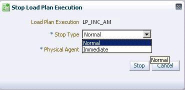

This displays the Stop Load Plan Execution dialog box, as depicted in the following figure:
Select Normal from the Stop Type drop-down list.
Select OracleDIAgent from the Physical Agent drop-down list.
Click Stop. This displays the Information dialog box with the Load Plan was Stopped Successfully confirmation message, as depicted in the following figure:

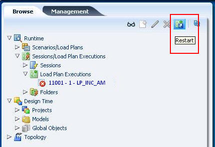

Select the Load Plan, which you want to restart, in the Load Plan Executions folder of the Sessions/Load Plan Executions section and click Restart, as shown in the following figure:
This displays the Restart Load Plan Execution dialog box, as depicted in the following figure:
Click Restart. This displays the Information dialog box with the Load Plan restarted message, as depicted in the following figure:
Click OK.
