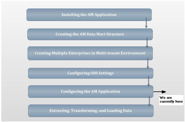

The following figure depicts your progress in the complete installation process:
Figure 6-1 Installation Progress: Configuring the AM Application
Surrounding text describes Figure 6-1 .

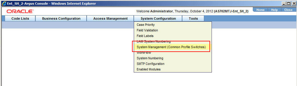

  1. Log on to the Argus Safety Console and navigate to System Configuration > System Management (Common Profile Switches), as shown in the following figure:
    Figure 6-2 System Management Link on Argus Safety Console
    Surrounding text describes Figure 6-2 .

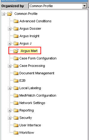

    This displays the Common Profile Screen with the list of configuration options in the left pane, as depicted in the following figure:
    Figure 6-3 Argus Mart Link in Argus Safety Console
    Surrounding text describes Figure 6-3 .

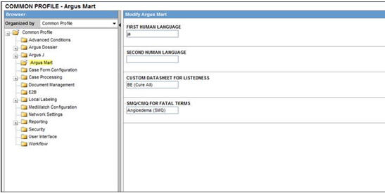

  2. Click Argus Mart. This displays the Modify Argus Mart Screen with the list of AM Common Profile Switches that you need to configure, in the right pane, as depicted in the following figure:
    Figure 6-4 List of Common Profile Switches for AM
    Surrounding text describes Figure 6-4 .

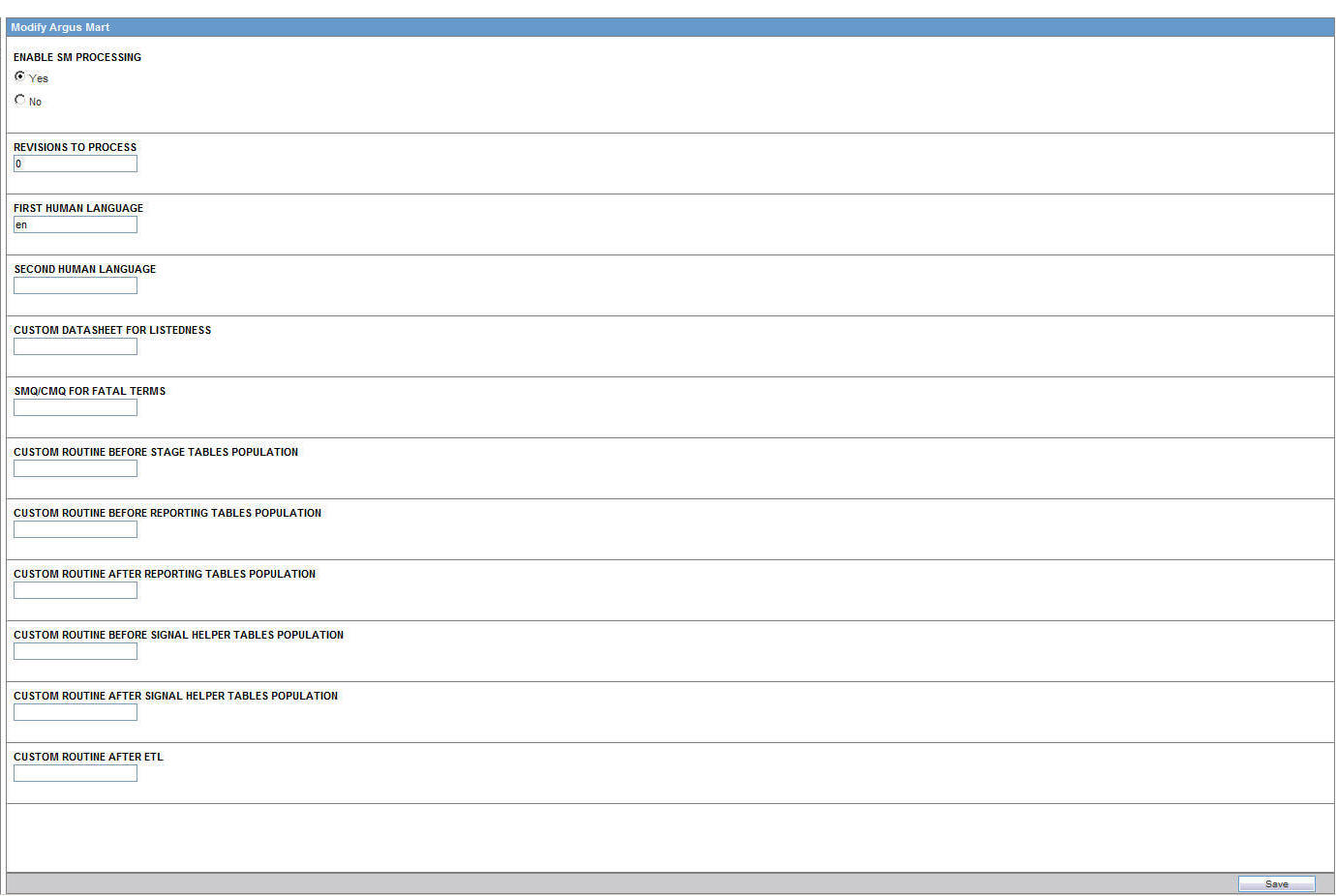

    There are 12 AM Common Profile Switches that you can configure using this screen. See Table 6-1 for description about these profile switches along with their type (Global or Enterprise-specific).
    The Global switches are visible only if you are logged in from a default enterprise. If you are logged in from a non-default enterprise, only the enterprise-specific switches are visible in the list of Common Profile Switches, as depicted in the following figure:
    Figure 6-5 Non-Default Enterprise: List of Common Profile Switches
    Surrounding text describes Figure 6-5 .
  3. Enter the required input in the text box (or select the radio buttons in case of the ENABLE SM PROCESSING profile switch) adjacent to the name of each profile switch and click Save.
    The Global Switches, as mentioned in the table below, impact all enterprises configured for AM whereas the Enterprise specific Switches impact the enterprise to which user is logged in, to access the Argus Safety console.
