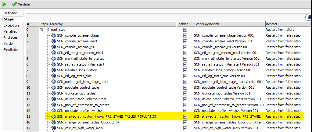

The ODI Load Plan lists all the ETL scenarios, as shown below:

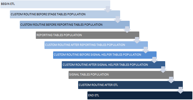

Argus Mart comprises the following ETL Hooks:
CUSTOM ROUTINE BEFORE STAGE TABLES POPULATION: This hook can be executed before populating the Staging tables.
CUSTOM ROUTINE BEFORE REPORTING TABLES POPULATION: This hook can be executed before populating the Reporting tables (or RM tables).
CUSTOM ROUTINE AFTER REPORTING TABLES POPULATION: This hook can be executed after populating the Reporting tables (or RM tables).
CUSTOM ROUTINE BEFORE SIGNAL HELPER TABLES POPULATION: This hook can be executed before populating the Signal Helper tables.
CUSTOM ROUTINE AFTER SIGNAL HELPER TABLES POPULATION: This hook can be executed after populating the Signal Helper tables.
CUSTOM ROUTINE AFTER ETL: This hook can be executed after running the initial or incremental ETL (post-ETL commit).

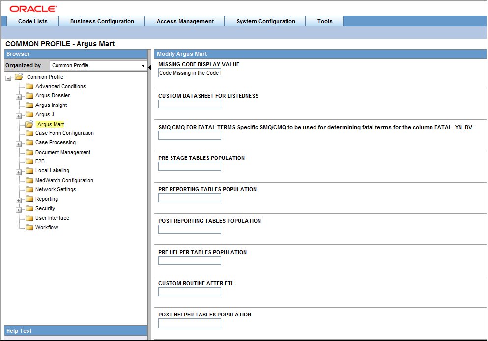

Follow the steps given below to view the Argus Safety user interface:
Log in to the Argus Safety application.
From the menu bar, click Argus Console.
The menu bar updates for Argus Console.
From the new menu bar, click System Configuration.
Click System Management (Common Profile Switches).
On the left hand side of the screen, a list of all system-managed common profile switches appears.
Expand the Common Profile folder and click Argus Mart.
The Modify Argus Mart page appears.

Follow the steps given below to execute an ETL Hook:
On the Modify Argus Mart page, enter a procedure name in the text box relevant to the ETL Hook execution stage. The ETL type can be initial or incremental where the customized data will be fetched. The ETL Hook will look for the database object that matches the procedure name.
A procedure name denotes the ETL Hook that comprises the custom procedure, or steps. Based on the stage (initial or incremental) where this procedure is being called, the data is modified before sending it to the destination tables.

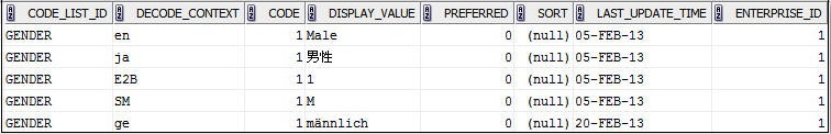

The following is an example to configure a code list display value in a new language for an already existing code in Argus Safety:

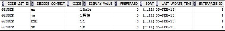

Example 2-1 Configuring Flexible Data Re-categorization
For a code list GENDER, data in the table CODE_LIST_DETAIL_DISCRETE for code 1 is available in the following four decode contexts (languages):
To configure the same code 1 in the code list GENDER for a new language such as GERMAN (decode context ge), populate the table CODE_LIST_DETAIL_DISCRETE with required values in the GERMAN language.
INSERT INTO CODE_LIST_DETAIL_DISCRETE (CODE_LIST_ID, DECODE_CONTEXT, CODE, DISPLAY_VALUE, PREFERRED, SORT, LAST_UPDATE_TIME, ENTERPRISE_ID) VALUES ( 'GENDER', 'ge', 1, 'männlich', 0, null, sysdate, 1);

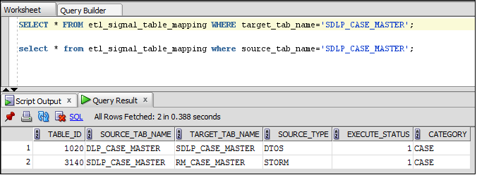

Check mapping between the source and the target tables, through the table ETL_SIGNAL_TABLE_MAPPING.
Based on the mapping between the Argus Safety and RM tables, fetch the desired column in the RM table through ETL Hooks.
There can be different source types to fetch data into tables at initial or incremental stages, such as:
ATOS - Argus Safety to Staging tables
DTOS - DLP to Staging tables
STORM - Staging to RM tables
STOSM - PRE_SM to SM Tables
Example 2-2 Populating a new column in the RM table
Follow the steps given below to populate a new column in the table RM_CASE_MASTER:
Check the mapping between RM_CASE_MASTER, and the source table (SDLP_CASE_MASTER) to fetch columns from the staging table into the RM table. In this case, the source type is STORM.
Check the source table for target table (SDLP_CASE_MASTER), where columns are fetched from Argus Safety into the staging table. In this case, the source type can be ATOS/DTOS.
Once the mapping of the tables has been identified, fetch these column(s) from Argus Safety/DLP into Argus Mart, as required.

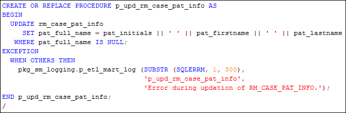

Example 2-3 Creating a custom procedure
Creating a procedure called P_UPD_RM_CASE_PAT_INFO, to populate a new column called PAT_FULL_NAME in the table RM_CASE_PAT_INFO. The value of this column is calculated, and populated from the existing columns of RM_CASE_PAT_INFO. Here, we concatenate three columns PAT_INITIALS, PAT_FIRSTNAME, and PAT_LASTNAME to populate this value as PAT_FULL_NAME.
Create a procedure called P_UPD_RM_CASE_PAT_INFO.
In the table RM_CASE_PAT_INFO, populate a new column called PAT_FULL_NAME.
Concatenate three columns PAT_INITIALS, PAT_FIRSTNAME, and PAT_LASTNAME to populate this value as PAT_FULL_NAME.
Once this procedure is created, call this procedure using ETL Hook PRE_REPORTING_TABLES_POPULATION.
The ETL Hook will populate this new column PAT_FULL_NAME in SDLP_CASE_PAT_INFO.

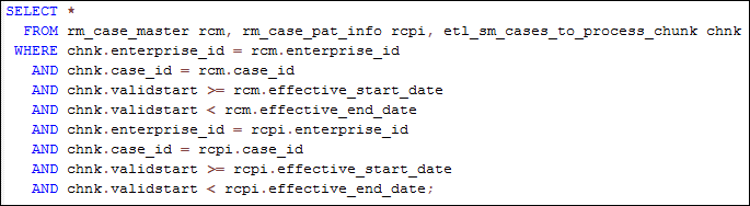

Example 2-4 Populating data into SM tables using the chunk table
In the example given below, two RM tables RM_CASE_MASTER and RM_CASE_PAT_INFO have been joined with the chunk table ETL_SM_CASES_TO_PROCESS_CHUNK to fetch data into the SM table with the help of the ETL Hooks.

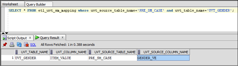

Follow the steps given below to populate a column in the table UVT_GENDER:
Check the mapping between the source table PRE_SM_CASE and the target table UVT_GENDER from the table ETL_UVT_SM_MAPPING.
After mapping the tables and their related columns, you can populate the column(s), as required.
