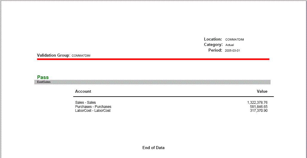

After exporting data to the target system, execute the Check step to display the Check report for the current POV. If check report data does not exist for the current POV, a blank page is displayed.
You can select the default report type that is used when Check reports are run. By default, the Publish Type field on the Reports page is set to the selected report-type value. Selections for this field are PDF, Excel, Word, Rich Text, and HTML.
Note: | When you run and open the check report from the Workbench, it is not saved to the FDMEE folder on the server. |
