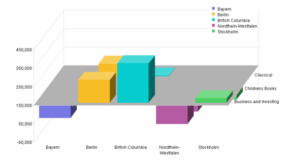

Use a baseline to shift the position of plotted data in the chart based on a threshold amount. Baselines are an effective tools to track actual progress against a targeted value. Baselines operate by changing the coordinate origins of the diagram. They gives the appearance of moving the X, Y or Y1 axis to another position. Data above the baseline amount appears in the top sector of the diagram separated by a break line from data below the baseline.
There a separate baseline settings for Y and Y1 axes. When the baselines is enabled, the horizontal axis (or horizontal plane for 3D charts) intersects both Y and Y1 axes at their baseline values.
In the following example, the baseline has been set at $150,000 for amount sales. Berlin, British Columbia, and Stockholm are above the baseline. Bayern and Nordfhein Westfhalen are below the baseline.
Image shows an example of a baseline used in a chart.
