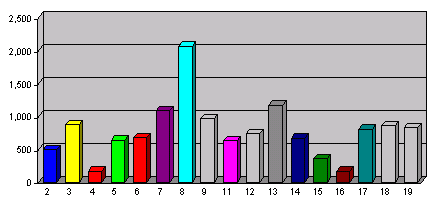

In the example below, the bar chart uses the default colors from the legacy color scheme:
Image shows a bar which uses default colors from the Legacy Color Palette.
