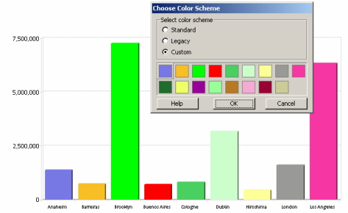

In the following example, a custom color scheme has been selected for the bar chart:
Graphic shows custom chart color scheme applied to a bar chart.
