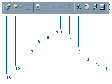

Standard Interactive Reporting Toolbar
The icons of the Interactive Reporting toolbar are specific to features used exclusively for Interactive Reporting document files:
Image shows the standard Interactive Reporting toolbar.
Table 231. Standard Interactive Reporting Toolbar options EPM Workspace
Number
Name
Description
1
Save
Saves the file locally and launches the Interactive Reporting document file in the Interactive Reporting Web Client so you can view the document and save it to your desktop for offline viewing (Interactive Reporting document files can be viewed only by the full desktop or Interactive Reporting Web Client. If the Interactive Reporting Web Client is not installed, the browser is launched automatically.)
Tip:
If you want to save the Interactive Reporting document file to the repository, select File, then Save or File, and then Save As.
2
Export to XLS
Exports a section to Excel and launches it inside your browser, if the MIME type is set to recognize the XLS file extension (Thereafter, the file is saved locally and manipulated through Excel. If the MIME type is not set to recognize the XLS file extension, a Save As dialog box is displayed, to enable you to save to a local location.)
3
Export to PDF
Exports a section to Portable Document Format (PDF) and launches it inside your browser, if the PDF MIME type is set in your browser (If the PDF MIME type is not set in your browser, the browser Save As dialog box is invoked.)
4
Refresh
In all but dashboard and report sections, refreshes the current section against the database server, to retrieve the most current data set
In dashboard and report sections, refreshes all queries, in the order in which they are displayed in the Sections catalog of the full client (For example, in an Interactive Reporting document file with Query1, Query2, and Query3, Query1 is executed first, Query2 is executed second, and so on.)
5
Page Right
In report and chart sections, moves one page or one view to the right, respectively (To move to the first page or view to the right, select Shift+Click+right arrow.)
6
Page Down
In report and chart sections, moves one page or one view down, respectively (To move to the bottom page or view, select Shift+Click+down arrow.)
7
Page Up
In report and chart sections, moves one page or one view up, respectively (To move to the top page or view, select Shift+Click+up arrow.)
8
Page Left
In report and chart sections, moves one page or one view, respectively, to the left (To move to the first page or view to the left, press Shift+Click+left arrow.)
9
Current Page
On the tooltip, displays the number of the current page
For chart types, except pie, scatter, and bubble, tooltips display data points on the x and y axes (Based on the Maximum Bars Displayed property in the Label Axis dialog box.)
10
Dashboard Home
Displays the dashboard Home section
11
Navigate Forward
Moves to the next section
12
Navigate Back
Returns to the last viewed section
13
Data Layout
Enables the Data Layout feature
