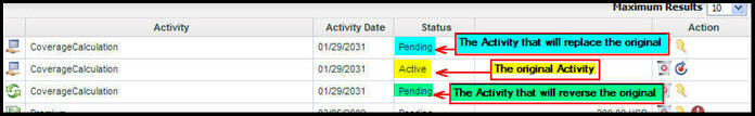

Selecting the Recycle button associated with an activity creates two additional activities to be processed. The first is a reversal activity that has green reversal arrows for its Activity Detail icon. The second activity replaces the original activity. The reversal activity must be processed prior to the new activity that will replace the original.
Step 1: Select the recycle button for an activity.
Two pending activities are generated in OIPA for the reversal and new activity.
Activity screen with two new activities created from the reversal
Two Pending Activities Generated For Recycle

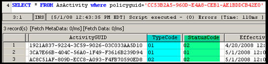

Two additional records are written to the database to track the reversal and new activity.
Database record with two new records for reversal and new activity
Reversal Records Written to Database

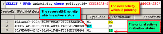

The status of the original activity’s record changes from 01(active) to 12(shadowed). The reversal activity changes from 02(pending) to 01(active).

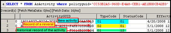

Database record showing new actiivity as pending, reversal activity as active and old activity as shadowed.
Reversal Activity in the Database

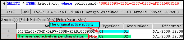

There are now two records, one for the original activity and one for the reversal activity.
Database records for original activity and reversal activity
Two Reversal Activities in Database
