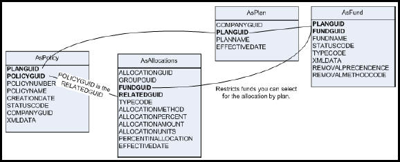

Allocation data is stored in the AsAllocation database table. The AsAllocations table is linked to the AsPolicy, AsPlan and AsActivity tables through the RelatedGUID column.
Allocation Tables
Allocation Table and Related Tables
