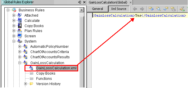

Navigate to the Global Rules Explorer.
Expand the Business Rules | System | GainLossCalculation folders.
Check-out the GainLossCalculation.xml file or create a plan or transaction level override of the rule.
Configure the business rule.
Check-in the rule to save the changes to the database.
GainLossCalculation Rule in Global Rules Explorer
