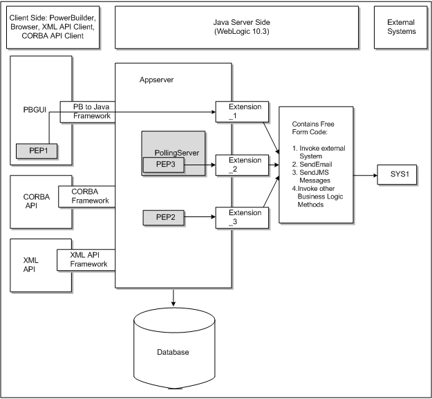

Figure 1-1 shows the architecture of MetaSolv Solution and how the various system components interact to support custom extension functionality.
Figure 1-1 Architecture Supporting Extension Functionality
You can invoke extension logic through the UI when the specified action, defined by an execution point (combination of building block, process point, and action type), occurs. For example, a user assigning a jeopardy code to a task is a specific action that can invoke an extension, if that action is defined as an execution point. Specifically, you would choose the execution point combines the building block type of Task Type, process point of Task Maintenance, and action type of Assign Jeopardy.
You can invoke extension logic through a call to an XML API method when the specified action, defined by an execution point (combination of building block, process point, and action type), occurs. For example, a third party calling the addTaskJeopardyRequest method to assign a jeopardy code to a task is a specific action that can invoke an extension, if that action is defined as an execution point. Specifically, you would choose the execution point that combines the building block type of Task Type, process point of Task Maintenance, and action type of Assign Jeopardy.
You can invoke extension logic through a call to a CORBA API method when the specified action, defined by an execution point (combination of building block, process point, and action type), occurs. For example, a third party calling the deleteTaskJeopardy method to remove a jeopardy code from a task is a specific action that can invoke an extension, if that action is defined as an execution point. Specifically, you would choose the execution point that combines the building block type of Task Type, process point of Task Maintenance, and action type of Assign Jeopardy.
You can invoke extension logic through polling servers as well. These servers, which need to be configured in the gateway.ini file, are listed on the following page. See "Additional Configurations" for detailed information regarding these configurations.
Polling servers can invoke extension logic if the action of the polling server is defined as an execution point. For example, a task that is defined as a system task with a task execution point of Ready is automatically picked up by the System Task Server when the task status becomes Ready. If the task completion logic that runs on the server fails, extension logic can be invoked if it defines that as an execution point. Specifically, you would choose the execution point that combines the building block type of Task Type, process point of Task Maintenance, and action type of System Task Failure.
