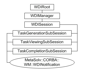

Figure 14-1 shows the relationship of the interfaces within the Work Management API.

When the Work Management API is the client, the overall process flows as follows:
The API client binds to the third-party server to get a WDIRoot object reference.
The API client invokes the connect operation of the WDIRoot interface, which yields a WDIManager object reference.
The API client invokes the startSignal operation of the WDIManager interface to get a WDISignal object reference.
The API client invokes the eventOccurred operation of the WDISignal interface passing a WDIEvent structure to notify the third-party application that an event registered to them has occurred within the database.
The API client invokes the destroySignal operation of the WDIManager interface.
The API client invokes the disconnect operation of the WDIRoot interface.
Once the third-party server completes processing, possibly involving additional unsolicited messages to the MetaSolv Solution Application Server, the third party server binds to the application server and follows the same process described above for the MetaSolv Solution client with the exception that the eventCompleted/Errored operations are invoked passing the original WDIEvent structure.
If the third-party application encounters an error, it throws a WDIExcp as defined by the IDL. The client handles CORBA system exceptions and WDIExcp exceptions.

Table 14-7 lists the interfaces and operations that the Work Management API server (DLRSERVER) implements using the IDL files provided with the Work Management API.
Table 14-7 Work Management API Unsolicited Message Operations
| Interface | For Implementing Only These Operations |
WDIRoot |
connect disconnect |
WDIManager |
startTransaction destroyTransaction |
WDITransaction |
commit rollback |
WMSession |
getWMSession |
