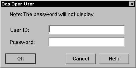

Only one user can log in at a time. This prevents people on different workstations from clashing over the same resources. If the InUse flag is inadvertently left on, usually through a crash or power off, a system supervisor can run this utility to unlock that user's ID. Then the user can log on as usual.
This window appears when you run this utility:
